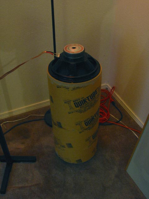

Heh, here's my 1 yr old "almost finished" sonotube. Looks pretty similar ehh!
This is one good looking Iso sub.

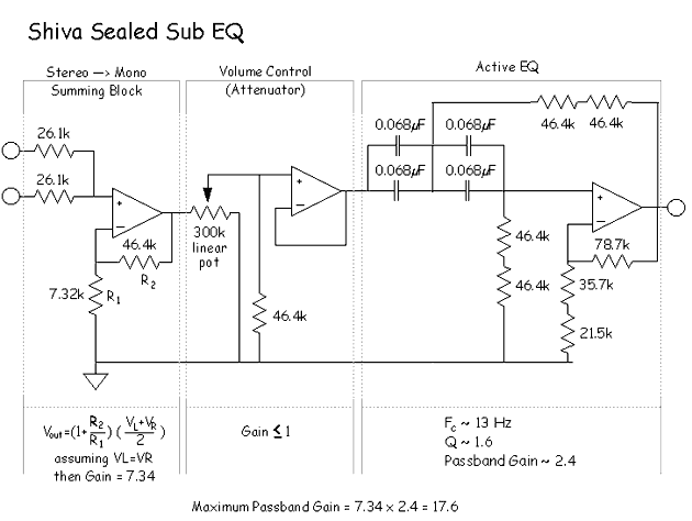

An example of how two channels can be turned into mono (taken from http://www.snippets.org/filters/shivaeq.htm):
Wire the two subs in series, but out of phase.
You will have an 8ohm load and your amp will be happy, and as was said, it will be plenty loud.

So am I just going to connect the Left and right out from my preamp to 26.1k resistor -> Y- Adapter -> another Y- Adapter to split the mono-> to sub amp-> left and right to seperate driver if I don't need the gain? Can this suming block be passive? If I need the gain what is that triangle represent, some kind of chip, opamp?stappvargen said:An example of how two channels can be turned into mono

- My almost finished sub
