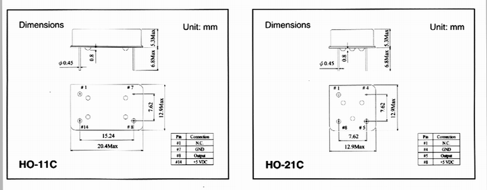

pinout of standard crystal oszillators ?
Joined 2002
Like this?
Arne K

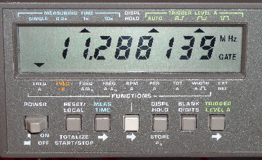

On the Marantz CD-16, (33,xxxMHz), I could easily hear the change when tuning while playing.
And when comparing Tent XO with LC A.XO2, they sounded very similar when I tuned the LC A.XO2 off by the same amount to match the Tent XO (wich was a bit off).
=> Maybe the Tent XO would have sounded better if it was 100% correct ? (but it lost out in this test, and found a home elswhere...)

Of course you can hear the change while tuning during playback !!!
How much was the Tent XO off ?
It works
I can't say if the sound is better, too much time has passed since I have listened to that player.

Swapping Crystal
Bernhard said:
Yes, thanks, the left one is it bottom view ?
I like to open one and swap crystal for the Philips one.

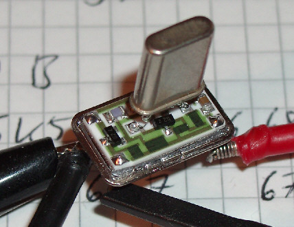

Hi Bernard,
It totally evades me what you want to accomplish.
If your canned oscillator contains a 74HCU04 it is totally useless as this is NOT low jitter and not one Cent better than the standard oscillator in the CD player. I suspect it is a CMOS Pierce type oscillator indeed considering its price (1 Euro).

I think Elso points out that the canned oscillator you're using might contain a 74HCU04 CMOS Pierce type oscillator which makes it the same as the standard clock circuit, or slightly less worse.
Hi Elso,
where have you got HC04 from? The photo clearly shows two SOT23 devices together with four thick film resistors, one X7R blocking capacitor and another COG(NPO) coupling capacitor. It seems that the circuit uses grounded emitter output stage. Pretty much standard discrete design.
Best regards,
Jaka Racman
