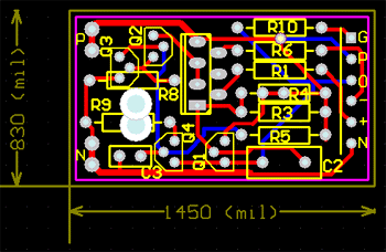

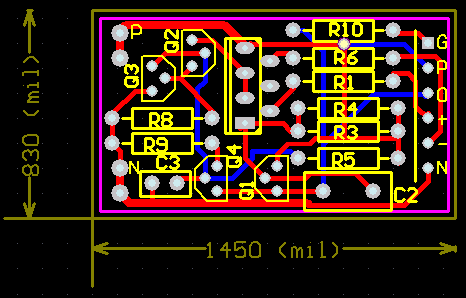

Updated opamp PCB. Can be used singly as SIP-6 or two together as dual DIP8 replacement. I'd welcome comments in the opamp thread.
Eight of these are included for $9; I'd like to get this price down to $4-5 but will depend on the number of orders. Please sign up in the wiki!
