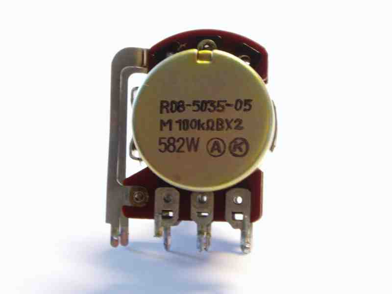

Ok,
Here is a picture of the pot in the attached file.
I found the radioshack reference number 271-1732. BUT they do not sell internationally!!!
So can someone buy this pot for me in the US and send it to me in Greece. I will pay all the costs.

it's a linear pot!
Hi gchrist
Yup that's a 100k linear taper! I may have one for you. I'll look in my junk/spare parts bin. Rat Shacks 100k pot is an audio/log taper and wouldn't be a good match in your case. You'll find your self having to use more of the upper part of the Vol. control's rotation to reach the same vol level and the bass boost will be a little less. But you may or may not find the result more to your liking.
And by the way, what's wrong with the original pot? If it's noisy you may just need to clean it! Caig makes some excellent stuff just for that. Also Silicone Lubricant spray made by Prestone works good because it doesn't contain acetone which will eat the plastic parts of the volume control, too aggressive! Some people have used WD-40 with ok results. I don't like to use it for that, the oil in it attracks dirt and dust and doesn't last long.
