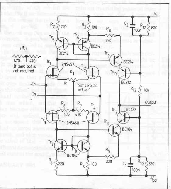

"Replacing the load resistors in input stage with current mirror. "
Who ever suggested that has never seen the schematic, won't work. The VAS devices are biased by the DC developed across the load resistors, its a complementary design.

fab:I am not the one who suggested it but nothing is impossible. In Elect. & Wireless World issue of January 1985, it was described a symetric complementary discrete op-amp with current mirrors for negative and positive loads of input pairs. Question: Using the referenced Leach v 4.5, could Q8 with R21 imposes a fixed DC voltage at base of Q12 so a current mirror could be used (a course the same would apply for the negative complementary part of circuit)?

"fab:I am not the one who suggested it but nothing is impossible. In Elect. & Wireless World issue of January 1985, it was described a symetric complementary discrete op-amp with current mirrors for negative and positive loads of input pairs. Question: Using the referenced Leach v 4.5, could Q8 with R21 imposes a fixed DC voltage at base of Q12 so a current mirror could be used (a course the same would apply for the negative complementary part of circuit)?"
Q8 is part of the short circuit protection and being engaged all the time would present such a heavy load as to negate the advantages of CCS loading. I don't like the sound either.

Actually, yes, current mirrors can safely replace the load resistors in this amp. The technique is commonplace in IC design, I certainly did not invent it. The mirror is a differential Darlington structure, which acts as both an excellent mirror and a buffer to the next stage and has well defined output levels to bias the VAS.

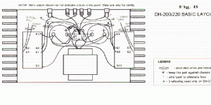

For the speaker ground, I have connected it directly at main filter caps instead of passing through the pc board as suggested by Musical-concept (see attached file because it looks like their site has been hacked!)

Can you draw your current mirror for our knowledge (remember that the VAS does not have a current source)?

It is good, provided it can be implemented.
In a discrete symmetrical topology, where the VAS consists of Darlingtons (like the DH-220), it is extraordinarily difficult to use active loads due to the lack of precision on the input stage.

I found the article. See by yourself the scanned circuit. I believe it is John Linsley Hood design.
There's also an article in Randy Slone's "High Power Audio Amplifier Construction Manual" that is related.
A symmetrical amp with current mirrors at the diff inputs coupled to a darlington VAS is featured in Fig 7.6a.
He then followed up with cascodes in the VAS and lastly the drivers and the lateral mosfets in the current stage are in CF fashion.
I have checked the diy forum titled "Unstable VAS current in amp from Slone book" and I saw the Stochino-based amplifier which incorporates also current mirrors in symetrical input stage (I already had this schematic but I don't know why I have fogotten about it...) I do not have the book on Slone circuit (does anybody can scan it and post it?)

What is the method you have "alluded to" earlier for current mirror use in sym input amp?
The cascode in the VAS is one of the mods I have done in my DH-200 amps and I am pleased with the results. What is the best base voltage for the cascode transistor?
"...current stage are in CF fashion": Slone's circuit required please.
