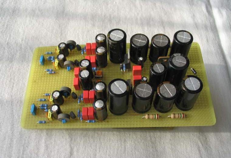

My OPA 660 I-V stage for TDA 1541A
no.1

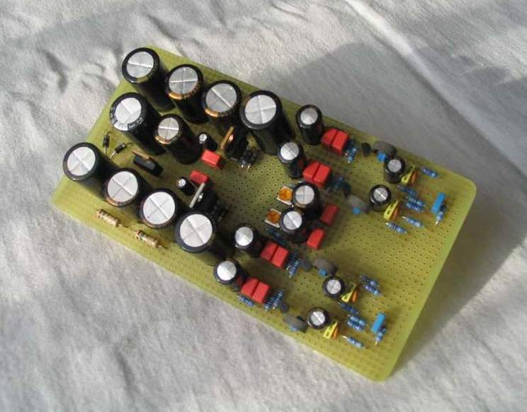

Firstable big thanks to Thorsten Loesch ,who shared his circuit with us.
Recently I got the idea to buy two identical old Marantz players (CDM4/TDA1541A) to make mods on them.This gives me the chance to compare the player with mod and the one without it as I'm doing mods step by step.If I like the mod I apply it to second player and go to another one.
Building this OPA660 I-V I followed some PS suggestions of Appasanger,who biuld and posted this circuit here some time ago.The board contains PS for 5V current injection (7805 regulator) and PS for OPA 660 (317/337 as pre regulators).I didn't use coupling caps at the output as I'm using preamp with caps at the input.All parts are lower/medium quality: Vithrohm 1% metal film resistors and cheap Hitano ,low ESR 105 c. PS caps along with some Wimas.It was hard to adjust zero DC offset with the pots at first (actually imposible for the first three days),but after it burned in it's quite easy to adjust it for zero Volts.
It drifts a bit but usually no more than 5mV.
As to the sound (I've been listening to this analog stage for some two weeks ,now):
Before I was using orginal Marantz circuit with OPA-s changed for BB 2604 and getting rid of muting transistors.It surely represents higher level of performance.The soundstage is wider and there is much more details ten before.But to be honest I don'tlike it!
The sound is a little too bright and edgy for my taste.It lacks some smoothness and richness.
The bass is very well controled but there is less of it then before (tonal balance suffers a bit).Orginal moded stage has less detail and space but better tone and makes music more involving.
NON-OS mode
I tried two TDA1543 non-os DACs and didn't like it much (I don't know wheather non-os or TDA1543).I also tried this player in non-os mode with original analog stage,didn't like it either (supposedly it would have to be rebuild to work properly).
I tried this OPA660 stage in non-os ,but without adding low pass filter as suggested.
I must say this is the first time I think it sounded quite good.But still ,I prefer this one with SAA7220.Although the sound seemed more natural I hear some chaos,image seems to be a bit "cloudy" and highs a bit harsh.
The system I tried it was Aleph P and Aleph 3 clones and Altec 891 studio monitors.

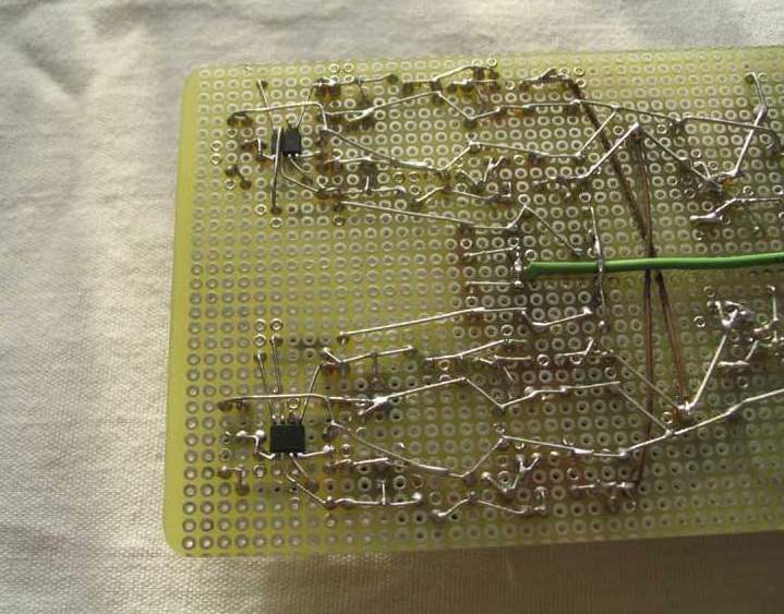

zygibajt, you have poor PSU bypassing on the OPA660s, because the caps are all on the same side of the chip (far from one of the PSU pins).
This is normal even in commercial products, and if your Marantz CDP has the PSU caps positioned this way (like my CD52SE) you missed an opportunity to listen to the OPA2604 in all it's glory.
What exactly do you mean by that?
From the point where the big caps on the picture end, every OPA660 has its own + and - supply with own caps.
I don't use 2604 and orginal Marantz analog output circuit now.The output from the DAC is taken to the board from the picture,so don't exactly understand what you mean.
Now, I still listen to and use this OPA 660 analog stage and I must say it sound really good,no comparison to moded Marantz's output circuitry,but still not my taste.
Will soon try tube or super pair.

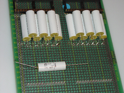

I just want to report that I just changed yesterday all 14 decoupling caps on TDA1541A!
I must say the diffrance is quite big and wothwhile!
Especially in case of those SMD ones.I just threw all of them away and put 14 1uF/63V Philips film caps at the top side of the PCB,directly on the pins (sorry ,no picture right now).
Great mod! More detail,bass and lower midrange got much better.
If anyone have any suggestions for better type of those caps than Philips I would appreciate it (I already used SEARCH function on that but maybe some fresh expirences?).
The only thing is they have to be small in size.

You could use these:
ERO MKP 1839 1µF

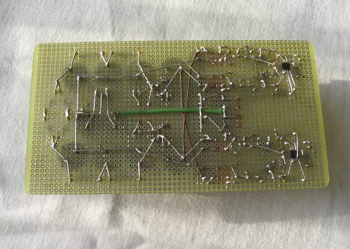

WRT your implementation, you really need to use a ground plane.
If hand wiring, grab a peice of copper sided PCB and go from
there.
