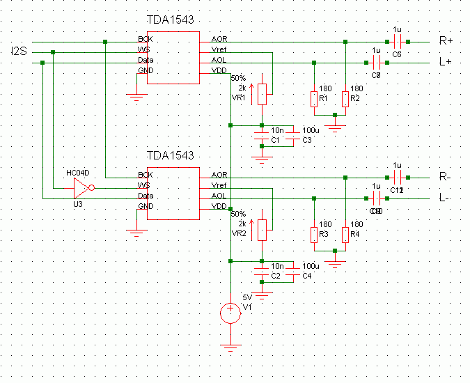

Simple: one dac for L+ and R+ connected in the normal way.
other dac for L- and R- by inverting the dataline.
one dac for L+/L- and one for R+/R- here:

Because i don´t know much about DACs, the moste complicated circuit i dealt with are those until now: http://home.tu-clausthal.de/~tpa/
But ok, the most simple variant would be like this?
(should we ask a moderator to split threads as this isn´t "TDA1541A/S1 Arrangements" ?)
Near enough except the inverter should be on the data line.
