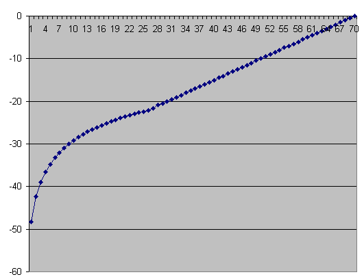

What do you think about my cherry-picking?
I’ve picked 70 out of the 255 possible steps, I find nice looking together.
Do you thing I should look for another setting, or is this one find?
BR
/loovet

When you look at the attenuation circuit you can see that it is in fact a voltage divider which
can switch the resistors between being a series resistor and a parallel resistor. You can
then make a spreadsheet using the formula's from here where you make columns from 1 to
254 (but then in binary, so 8 columns) which decide if a resistor is in series or parallel. The
values 0 and 255 are not possible, because then no resistor is in series resp. parallel. Then
choose the values so that you get a curve as displayed in a previous post.
