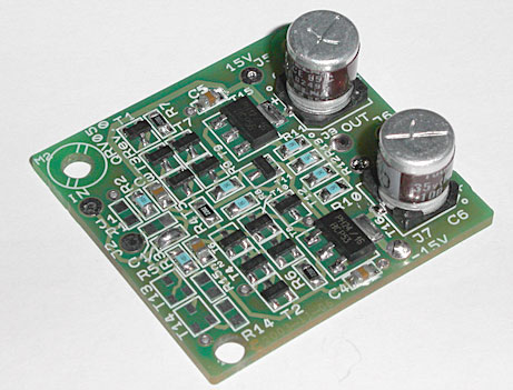

I have made a small SMD diamond buffer.
Rise tíme less than 10 ns. I can't see any difference between input signal and output signal. This buffer fast......
400 mA peak (at least) at +- 15 volts. The groundpplane can cool rather much!
Noise floor below -110 dB (less than the soundcard)
Offset 7.8 mV
Dist less than 0.009% Can't see any difference between the soundcard alone and the buffer. Walter Jung mentioned in his article dist down to 0.002% which seems to be true.
Those of you who want to see the RightMark results, send me a message.

Excellent looking PCB as usual. Very nice.
I'd like to see mounting holes in all 4 corners though. Makes me sleep better knowing that it is securely mounted. I am fairly sure Peter Daniel prefers the vibration characteristics better that way also...

Per, on the schematic (Boy, what a schematic! There's probably enough parts in there for a 6-channel THX amp. But I like it, nicely symmetric and elegant. Sometimes diagrams have their own beauty aside from their utility), the left-up transistor, I think it is T11, with the collector connected to the input, is that correct? Or is it supposed to go to gnd?

So this will be a 'beautyful-buffer' until you accidentally short output to ground, use too low load impedance or reverse supply :D then it should turn into a 'hell-to-repair-buffer' :bawling:
Nice design Per! I agree with you that SMD makes it look so much nicer, and there is less parasitics to worry about too.
However, looking at your distortion numbers, I could not find out which load you were measuring into, 10k? 1k? 100?
Also is the measurement with the buffer inside the feedback-loop of an op-amp or not?
