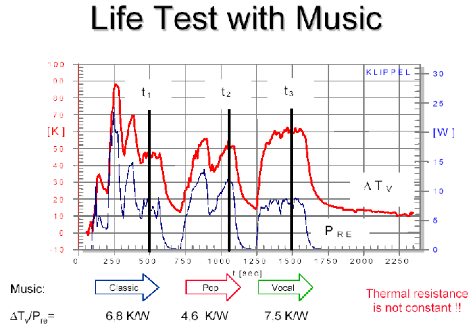

The peak/average ratio for speech/music, averaged over the several second thermal time constant of a voice coil, is in excess of 10dB. If the coil over-heats (melts -or- compresses) at 20 watts, then we need way more than 200 watts of amplifier. If the cone is working down to its bass power limit, it slaps before it overheats.
Find out for yourself if thermal compression is an issue. Put a double-pole switch on the speaker, so you can instantly switch the speaker from amplifier to ohm-meter. Lock the meter on the 19.9Ω range so you get a reading without waiting for auto-range. Measure the speaker's cold resitance. Play the speaker loud for several minutes. Switch to ohm-meter, get a reading much-much quicker than 10 seconds (a typical time constant for voice coil thermal mass). To be exhaustive, play loud for several hours to warm-up the magnet (the voice coil's main heatsink, with a time constant of several minutes) and check again.
I suspect (but have not experimented) that if you are not clipping or slapping, your voice coil resistance won't rise more than 10%.
Of course if it does rise as much as 50%, thermal compression is only a small part of the problem. Efficiency is half, effective damping (not damping factor) is half, response plots go whacky. This can't easily be compensated outside the speaker. If the coil is so hot its resistance rises, it is a "different" speaker than the one you bought. We are resourceful gentlemen and women; Why abuse a driver that much?

Why worry about fractional-percent harmonic nonlinearity – please stop it
There are three main contributions to loudspeaker non-linearities.
Firstly, non-linearities can be found in the motor & motor magnet system caused by variations in the bx l products with cone displacement, a change in the voice coil inductance and induced emf with the cone excursion, and heating effects.
Secondly, there are mechanical non-linearities due to suspension stiffness of the loudspeaker spider and outer rim, mechanical clipping, compression, & hysteresis effect of the voice coil, the cone material and design of the closed-box system.
The third factor which contributes to its non-linearities are the Doppler distortion effect. The Doppler effect causes mainly phase modulation because the time delay varies with the changed distance between moving diaphragm and fixed listening point.
Some (like Moir) believe modulation distortion is more objectionable, than harmonic. Other have disagreed. However, the least possible distortion, no matter what the origin, is a primary design goal.
For additional info please visit www.klippel.de

First of all, the first Hawksford paper on current drive is well worth reading. In fact, while he keeps emphasizing the compensation of the compression effect, the harmonic distortion reduction is probably more important and impressive.
It should not be forgotten that harmonic distortion is caused by motor and suspension nonlinearities. The other, and probably more harmful manisfestation of these nonlinearities is IMD. And I am pretty sure that this kind of IMD sounds nastier than Doppler IMD, which is essentially a linear mixing process. By the way, both kinds can be countered by using larger drivers, at the cost of polar response.
I do agree with PRR that VC heating is most probably insignificant in cone drivers (both due to its small magnitude and long time constant), but what about tweeters, especially ribbon drivers which have a very low thermal mass?
