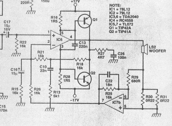

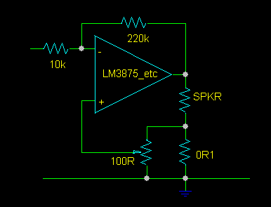

Diving right into it, negative output impedance can be useful under certain circumstances because it can at least partially compensate for the resistance of the speaker voice coil. If the coil resistance (not impedance) was zero then the speaker would do just exactly what the drive waveform was telling it to do. The fundamental resonance would be flattened out almost completely. The rolling off at low frequencies in a small sealed box would not occur - at least within the cone excursion limits.
What this cct does is measure the current through the speaker and send back to the non-inverting input a voltage proportional to the voice coil current. This voltage is then amplified in the normal way, in addition to the signal, and it is this extra voltage that will be dropped in the voice coil resistance.
I did make up one of these ccts once before in a different amplifier and if you wind up the pot to far it will gradually slide into instability. It is positive feedback after all. But it does work!
All you need to add to your gainclone or whatever is a low value sensing resistor and a small pot. Tonight I am going to try it myself.

And the voice coil resistance is not constant, but signal level dependent. Big problem, Eye Knowz....
NI, been there, done that, got the T-Shirt, NDFG.
Actually, that is chemically pure bovine excrement. Normal electrodynamic drivers are pure current controlled devices and will do anything but what the waveform applied as voltage tells them. If we convert the system to current drive the voice coil resistance becomes irelevant, as does compression and several distortion mechanisms.
The only "price" to pay is that we now need to handle the mechanical resonance of the driver mechanically (for example apperiodic boxes) instead of hiding the mechanical system resonance behind the "damping factor" magical trick.
Actually, with fully compensated voice coil DCR the driver does NOT have a linear response, it is actually a rising response, but rising at a constant rate and thus easily equalised. Of course, as the voicecoil varies in resitance with signal and as it has also material inductance the resulting system is highly unstable. I shot quite a few bass drivers to the lake of fire and sulphur before giving up.
If you want to contol the cone accuratley at high excursion (LF) the best way is still to have a sensor, for anything with modest movement current drive sufficiently above the resonance is an excellent solution.

Raka said:Not for you, Circlotron, but for all the newbies like me, there is an article about this in the ESP pages that could make a good reading.
Yup, he pretty much sums up the use of negative impedance in Effects of Source Impedance on Loudspeakers where he says:
Negative impedance does exactly what it implies - when the load is increased (with a lower impedance), the signal applied to the load increases (i.e. the exact opposite of what normally happens). This results in an intrinsically unstable system, and great care must be taken to prevent the creation of an oscillator.
The performance of this combination is completely unacceptable in every sense of the term. This combination could never be used in practice, for any reason. There is a vicious attack, with the signal doing something at a frequency completely unrelated to the input signal - unrelated in any way that I can determine, at least.
Considerable ringing is apparent (again at an unrelated frequency) when the signal is removed. This is highly visible and audible, and the sound of the attack and decay is grossly inferior to any other combination. The others (using positive impedance) have some character, but it is related to the signal, and makes some sort of musical sense.
se
As I mentioned in one or more articles on these pages, I have never found a cone speaker that "likes" negative impedance. Horn compression drivers seem quite happy and this is a test that I may now be forced to perform to find out what it does, and how it affects the sound (other than an apparent improvement in bandwidth).
From the link at Rod's home page http://www.sound.westhost.com/z-effects.htm
As I understand negative impedance is especially good for bass reflex woofer, not so good for a ordinary fullrange speaker. It must be carefully tuned!
The "negative" properties is to cancel out the resistance (losses) in the woofer element and the cables. This cancellation makes it easier to control both the helmholtz and the mechanical resonance.

I realize this is an old thread but I'm guessing there are others out there who might stumble upon it and give up for the wrong reasons. Perhaps the thread went off-topic too soon for anyone to comment.
I recently stumbled upon this thread, built the circuit and found that it didn't work.
So I took a closer look.
IIANM, the circuit diagram in the first post does not fit the description...
Please correct me if I'm wrong. It should read:
This voltage is then added to the amplified inverted signal.
That is what the circuit was supposed to do but I believe it does something else.What this cct does is measure the current through the speaker and send back to the non-inverting input a voltage proportional to the voice coil current. This voltage is then amplified in the normal way, in addition to the signal, and it is this extra voltage that will be dropped in the voice coil resistance.
No, the original description was correct. Imagine that there is 0V input signal, so 0V at the output would put 0V at the non-inverting input and the op amp is happy. If the input suddenly went to 1V the output would try to swing negative to match the inverting input voltage to the non-inverting input voltage. This causes the voltage at the non-inverting input to go below 0V. It is the differential input voltage that is amplified, so the voltage from the voice coil current is amplified in addition to the signal.
Thanks for the correction and explanation, Brian.
I find it quiet easy to get confused with some of these circuits but I'm back on track now.
Playing with this circuit it is quite a fun exercise for me.
I personally disagree with those who say that negative output impedance is a bad idea.
The results so far are certainly positive in terms of my audio preferences.
Agreed, it is not as good as having a sensor mounted to the voice-coil but it is much simpler and it's better than nothing.
