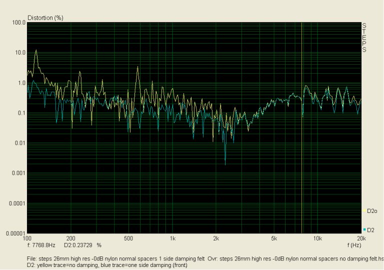

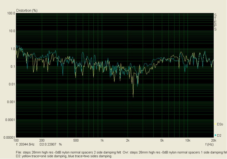

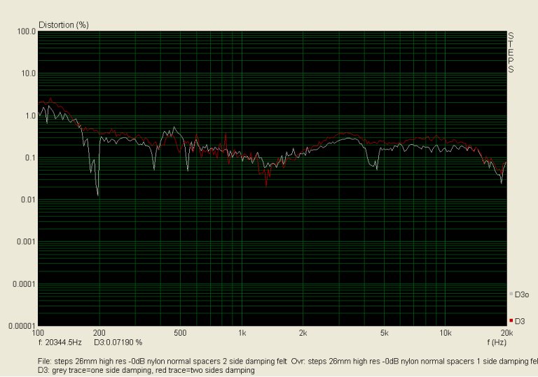

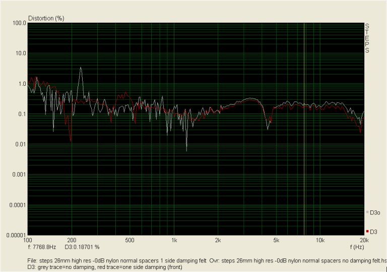

If you are interested I could do some measurements without damping, damping one one side and damping on both sides.
I had to do these measurements at a little higher output level (+9dB) because of background noise coming from outside of the house. So distortion levels may be a bit higher compared to previous measurements.
1. second harmonic, one side felt damping (blue) vs. no damping (yellow)
Don't mention it.
I agree there's no sign of asymmetric acoustic loading induced distortion to be found in those graphs. A good thing since some well known ESLs use this technique.
We do see some reduction in distortion, mainly 2nd harmonic, with a little damping. IMD shows the same (not posted).
I'll be posting some interesting stuff next.

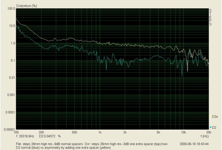

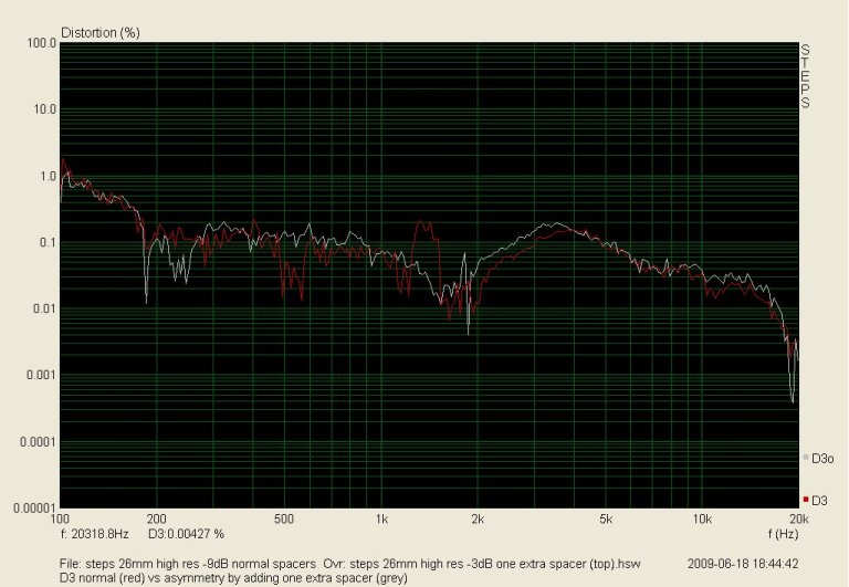

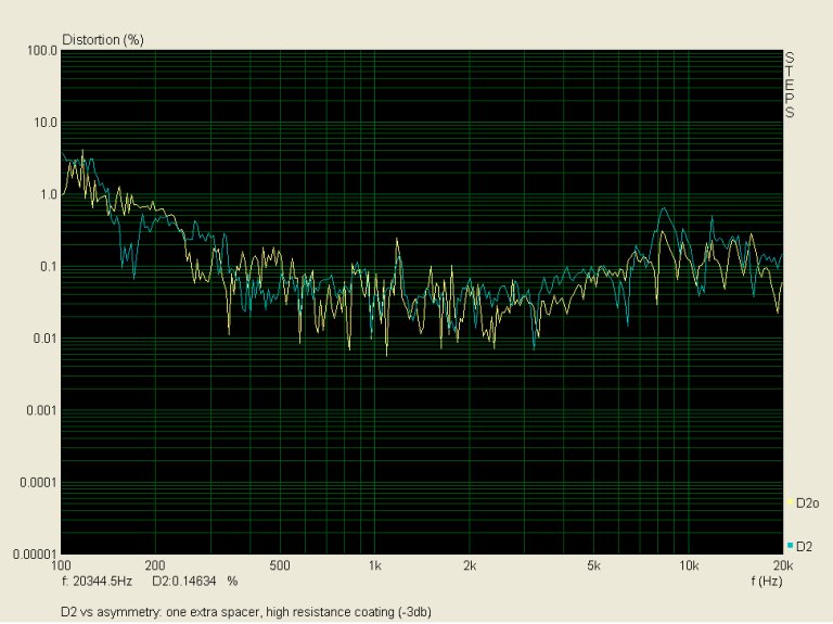

In post #1 we found a significant increase in second order harmonic distortion as a result of asymmetric diaphragm to stator distances.
Theoretically, we would not expect this increase in distortion in the ideal electrostatic panel. In the ideal case we have:
1. perfectly uniform electric field between the stators
2. constant charge operation
Those conditions would (theoretically) make it a perfectly linear device.
To make it more interesting I repeated the experiment but this time with a high surface resistance coating of about 4E11 instead of the 1E7 Ohms/square in post #1, thereby improving condition 2 above.
yellow trace: symmetric
blue trace: asymmetric
As we can see, no increase in second harmonic this time! We have actually improved the linearity of the device by raising the surface resistance of the coating.
That this is so, is confirmed by a significant drop in second harmonic compared to the measurement from post #1, especially in the mid range (0.03% vs 0.1%)
Wachara has commented that he could hear the difference between low and high resistance coating in his headphones. These measurements support that claim.
Unfortunately many commercially available coatings for ESLs are in the 1E7 to 1E8 range. I'd say this makes a strong case for higher S/R coatings!

Sure. The simple summary is:
1. constructional asymmetry can increase distortion in a real world electrostatic transducer. Speakers with higher SR coating are less effected by this than speakers with low SR coating.
Side note: the effects are probably marginal in our speakers, the experiment was done to confirm/bust the general opinion that distortion does not depend on asymmetry.
2. very high resistance diaphragm coating lowers distortion, also in the mid range. A value around 1E11 Ohms/square is adequate.
3. a small amount of damping lowers distortion in the low/mid range.
4. asymmetric acoustical loading (e.g. damping material on one side of the panel only) does not raise distortion like asymmetry in construction.
