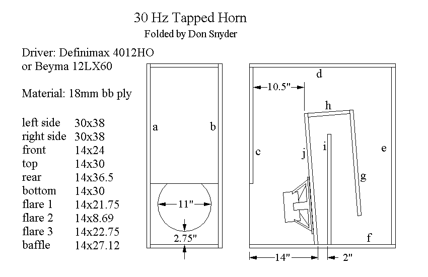

- 2-sheets of 3/4" 15-ply ApplePly used.
- The blue CAT5 will be used to power some RGB LEDs to illuminate the 1/2" Green-Edge CNC Carving / access panel.
- Coil will be installed later
Here are my current build pictures:

Wow, love the pictures and the build quality, very nice!! Although this is build very rugged, you might consider some bracings at large areas, Since I´m in Pro-Sound, I use similar plywood as you do and I´ve always had to add some bracings and it always improved the sound (and made rumble from the enclosure walls less).
Really nice work and great pics! I like that the driver is visible. My tapped horn is very similar in layout to yours and I get slick of putting on the hearing protection and sticking on my head in the mouth with a flashlight to monitor driver excursion.
I added a ton of bracing to mine, here's a pic if you're looking for some inspiration.

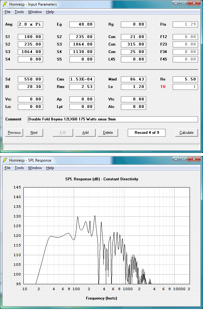

Don Snyder said:Now, lets turn up the power ...
1. What happens when the port chokes?
2. Doesn't the vented box run out of xmax first?
Ditto
In a 300 liters box is enough space for big enough portsDon Snyder said:1.What happens when the port chokes?
NoDon Snyder said:2. Doesn't the vented box run out of xmax first?
the tapped horn runs out of Xmax first
Visaton in germany measured a tapped horn and a vented box of the same size in their anechoic room. The surprising result was: the vented box went louder
Post #13
Post #13

I think a size distinction needs to be made here. If you are willing to live with a 300 L box, then maybe a ported enclosure is fine for some people. However, the main advantage to the tapped horn is its ability to play low, clean, and loud in enclosures smaller than what is needed for a ported box. Regardless the sizes, the tapped horn is more musical because it has a broader tuned bandpass than a ported enclosure. I've never heard a ported enclosure play anything but one note bass. That's what happens when you only have a tuned port to work with.

I did some corner braces (piece of wood 2''x2''x12'' on each of the inside fold corners. I also filled in that gap with expanding spray foam after it was completed. That space would be perfect though, for putting in a resonator or two, once you had figured out the correct length/tuning/etc.
I am thinking of having mine in a corner firing into the room through an opening in the door, and I would need to put on a small mouth extension to the horn. I am wondering if this would lower the tuning much.
