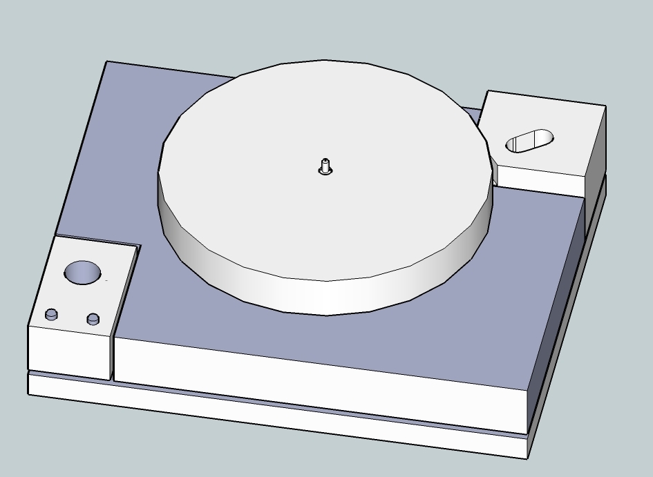

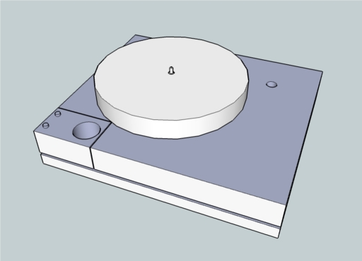

Thanks Stew,
That is a very nice read.
Do have by chance have any good photos of how to implement the motor pod 'attached' to the plinth, and a good way to have a fixed arm high enough to reach a taller platter?
I don't yet have the Teres platter, and I'm not sure if I am going to use on like it, but it would be useful to see some designs on how to get the arm to that height. The VTA can help a bit, but not that much.
I'm thinking my turntable will be much like that CAD image. Might have more rounded corners, and then I will just have another piece bellow that incorporates the motor pod. I think I will try and keep the armboard directly attached to the plinth.
-West
-West
the motor and arm "pods"
I would make them as separate pieces from the main plinth. You can then put them all on a slab of high mass (or ultra low-mass) material. There will be some very good isolation of the motor from the main bearing, and the tonearm. And the tonearm will be isolated from the platter bearing as well. There is an audible benefit to both.
The Teres is 3" I think, so the tonearm "plinth" (for lack of a better descriptor), could be made quite thick, or just the "off-centre" collar.
Look here for a picture of what I am talking about, although the offset from the mount would be much less. You could even make a 23mm X 35 mm or similar cut-out on the tonearm mount "plate". Using an aircraft style washer (very narrow shoulders), and the Rega nut would allow you to move it quite some distance, much like the SME "sled" style, but not as elegant.
For other ideas do a google search for "Teres turntable" under images. Tons pop up

Stew,
I really like that armboard design. Shouldn't be too hard to implement. Might look a bit 'off' on a square plinth, but thats okay.
Aengus,
I think I will give it a shot sometime, but for now I'm going to stick to wood. Also most of my blades and cutting tools are very nice and expensive, and I wouldn't want to bang them up on aluminum. My Woodworker II blades aren't going near it
-West
Aengus,
-West

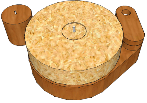

Alright, I know what I'll do.
It's going to be ALL wood. Nice hardwood for the top of the motor pod, so it's secure, and fill a lot of it with lead shot, but it should be nice an sturdy. Plus I think it will look nice.
The platter will be wood as well.
-West
My 12 1/2" planer is going to be VERY useful for all this. I want to make sure it is all perfectly flat.
-West

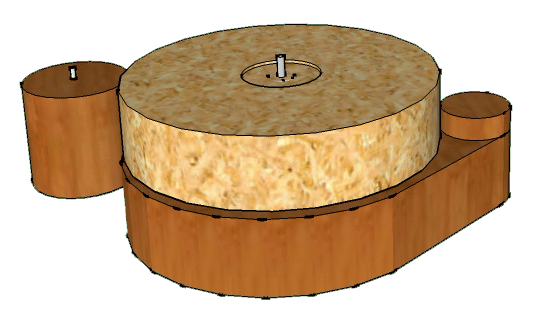

A more detailed explanation:
Platter:
Wood - Birds Eye Maple
Construction - Filled with lead shot.
Size - A bit over 12", with a soft edge on the outside, and an indent in the middle.
Plinth:
Wood -Mahogany or Cherry (Undecided)
Construction - Again, Filled with lead shot.
Size - area under platter will be the same size as the plater, with tangents over to the smaller circle, where the armboard will be mounted.
Armboard:
(Full armboard not shown bellow, it will be an extension off of the mounting platform that is in the photo.)
Wood - Same as Plinth
Construction: Will be bolted down. Bolt might be sunk in, and covered with a removable piece of wood.
Size - semi-circles on both sides, with radii the same as the edge of the plinth.
Motor House:
Wood - Same as plinth
Construction - Hollow with mounting plate on top, and cover on the bottom. A small flat section on the side for mounting the power connector. (Nuetrix). The bottom will then be filled with led shot to give it mass.
Motor Controller:
(Not shown)
Wood - Undecided, probably the same as the plinth.
Construction - Simple box, will have the 12V 18AH battery inside.
I also might build a larger plinth or stand to go under this all. Right now I am leaning towards a dedicated stand.
-West
