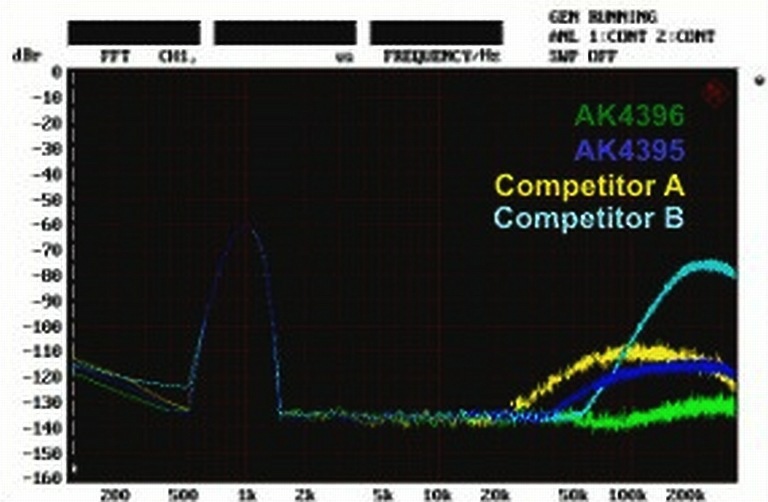

Here is an interesting graphic that you may not have seen. The AKM dacs feature a 2v voltage output and super low ultrasonic noise floor which enables them to run their analog output direct out to the output connector with no analog filters or buffers, still providing plenty of power to drive passive stepped attenuators. No active circuitry of any kind following them. This provides the purest, most detailed sound that I have heard. The direct out mod is very cheap to put into a DEQ2496 or various sound cards that use the AKM dacs needing only a high quality coupling cap to block the dc offset. Interestingly, I find that the sound of the 4395 has better fine resolution but the 4396 has a beautifully focused and powerful presentation.

jwb said:What kind of test signal is used?
To me it looks like 1kHz sine at -60dBFS and the measurement done with few FFT points or possibly a window choosed for truer represenatation of noise rather than static signals.

I'm using my AK4396's analog output pins directly without any filter/opamp/buffer etc. Just a 1K resistor between my Gainclone amp. I'm not very experienced listener but I don't know how could it sound better... Maybe tweaking with power supply section and changing oscillator for low jitter. That's all.

I assume you have a blocking cap on the input of the amp? Why the 1k series resistor?
I meant 1k resistor between gainclone chip and dacs. It's just reuired input resistor for chip. I'm using AK4396's balanced outputs for instrumentation amplification with LM3875/gainclone chip.
This implementation permits avoiding dc blocking issues (which requiring caps in signal path) if you are not connect ground pin of dac to amp. Just + - pins.
