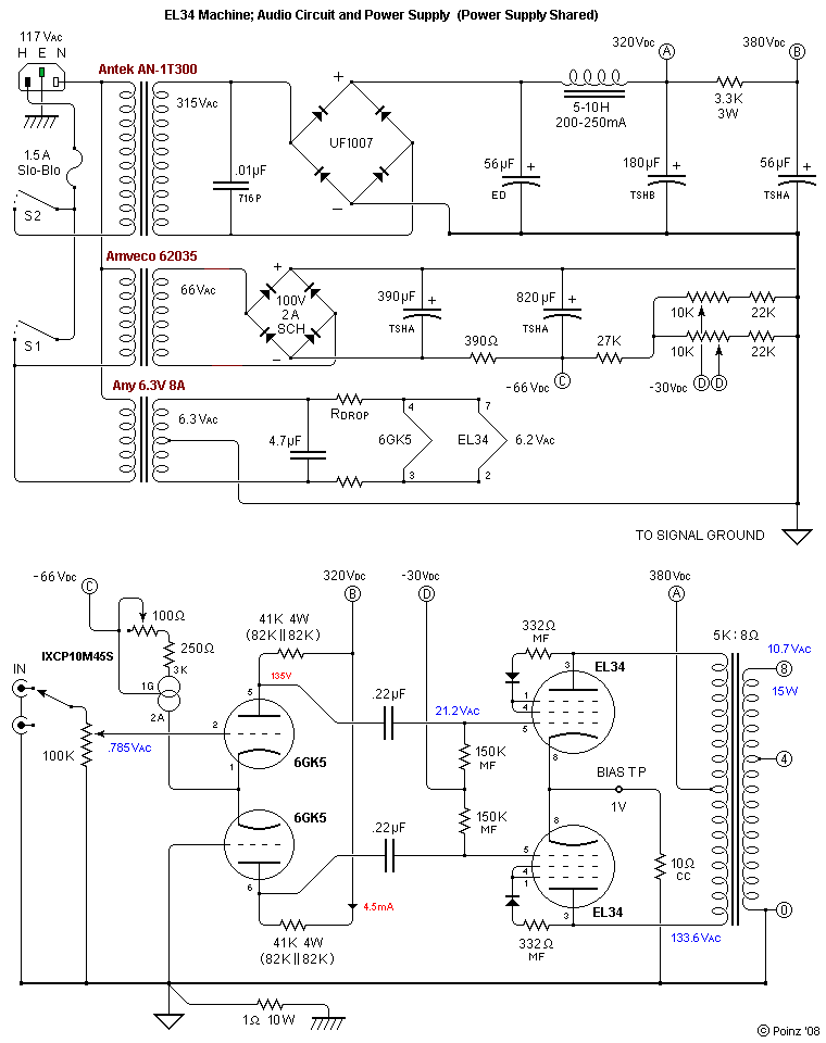

There is a newer version of this circuit that has a 6GK5 LTP driving the EL34's. I would be more than happy to post it but I would like Poinz's permission first. I know he is very kind to the DIY community being a DIYer himself, I just don't know how liberal he has been with this design.

OK I did some searching and I found the other schematic I was talking about posted around here so I will go ahead and slap it up. ...Poinz, if you read this and don't want it up I will have a mod take it down...
It doesn't use all octals like you requested but it is a simple and elegant way to get about 16watts from the minimum amount of gain stages. I talked with Poinz through email about this one, I have since deleted that email, but what I got was he liked this one better than his first EL34 amplifier (the one I linked).

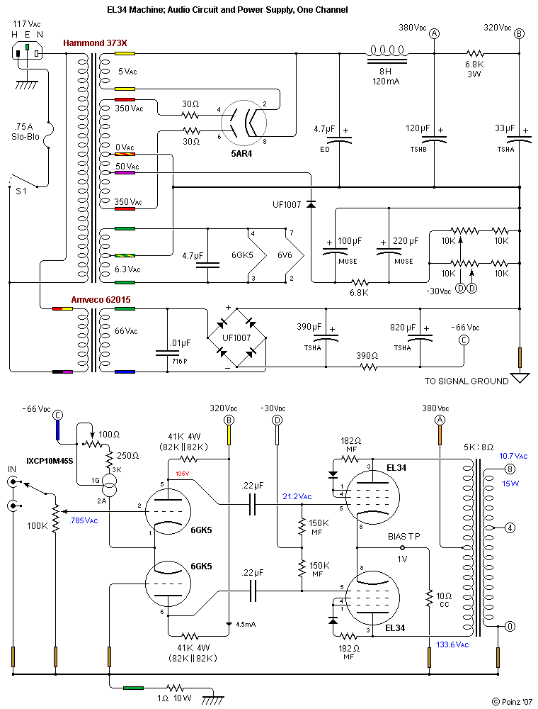

I am presently breadboarding Poindexter's 6GK5 amp shown above, and I was considering using a 5AR4 rectifier since my power transformer voltage was higher than 310V or so, but I only had the SS rectification PS schematic provided by Poinz.
Thank you for the 5AR4 PS schematic!
I'm sure I'll also have lots of newbie questions once the build is close to being finished. I'm using Hashimoto HW-60-5 output transformers and a one electron Power transformer.

Oh, and no problem with the 5AR4 schematic, Poinz was nice enough to send me both via email. Great guy and I am sure he would be willing to help with your build, along with all of us here!
