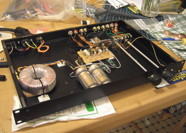

For now the chassis is a 1U steel rack-mount job from Maplin. Not my choice - it came with the first kit. Thanks to my old friend and former house-mate Mike

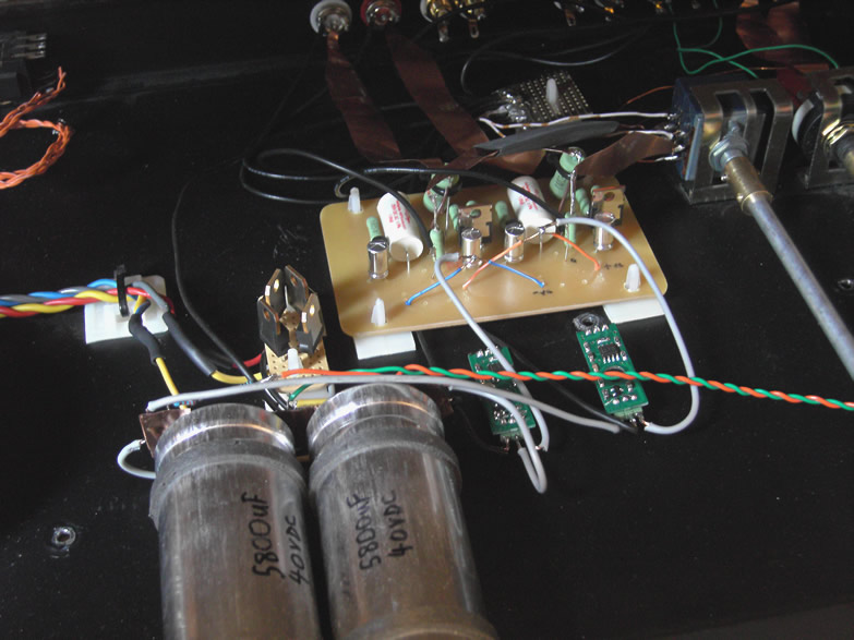

The transformer is an 80VA toroid that I had lying around. The rectifier is made of some large schottky diodes I found lying around, I'm not sure why I bought them originally. The smoothing caps are 5800uF/40V Sprague Powerlytics, very large for their capacitance. They are peeled and connected via copper foil screwed down - because I can't solder to the screw terminals and they don't hold ordinary wire very well - easiest would have been to source some "tags".
Next up is the regulators, which are Sercal S Power - brilliant devices! Local decoupling is peeled Rubycon ZA 100uF/50V. Power wiring is individual bits of Kimber 4VS I had from offcuts. Ground is the black parts of 4VS and it all joins on one star point, which is made from strip-board, caked in solder.

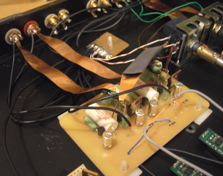

The other parts on the board are Mundorf MKP caps and Kiwame resistors. Not sure what the FETs and transistors are! Signal wiring is Mundorf copper foil which I insulated with spray PCB acrylic lacquer.

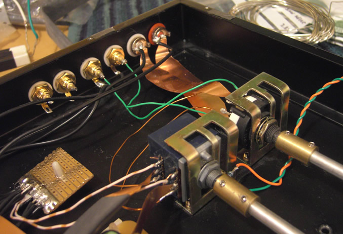

CDP in and the main output sockets are CMC thick silver over solid copper - the best RCAs?! Pot is Alps Blue 20k log. Selector is cheap Maplin job. These are placed near the back courtesy of some shaft extenders purchased from Lee @ DIY-Hifi. These are great but with one small problem - I can't get the knobs to line up perfectly straight.

Hi Ricardo,
Thanks! The copper foil sounds good and is cheap compared to other "audiophile" solutions, plus it gives the preamp a unique look inside. The sound is the main thing though.
I first used a 10k linear Vishay pot (that came with the bundle of stuff I first got), but I found a linear pot was terrible as a volume control - hard to get a "just right" volume and it had awful tracking /channel balance at the low volume range. I then tried a cheap 10k log pot, but this also had poor balance at the low range.
So for a double-whammy I moved to 20k (more range at lower levels) and Alps Blue type, as this is known to have exceptional channel balance. I get even L-R sound even at very, very low night time levels now.
