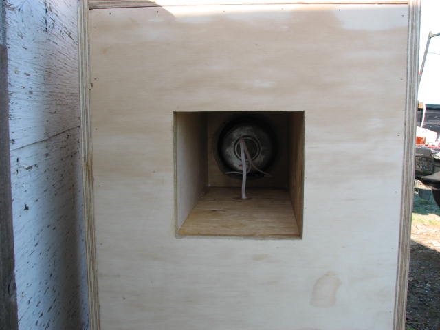

Another option is to go open back like this. The rear reflections are quite nice when placed a little away from the wall. Only problem is you need a deep cabinet to prevent cancellation. Works in this instance though where the cut off is higher than 90Hz. If you're set on a tuned cabinet, the others will have to chime in as I'm not the expert.

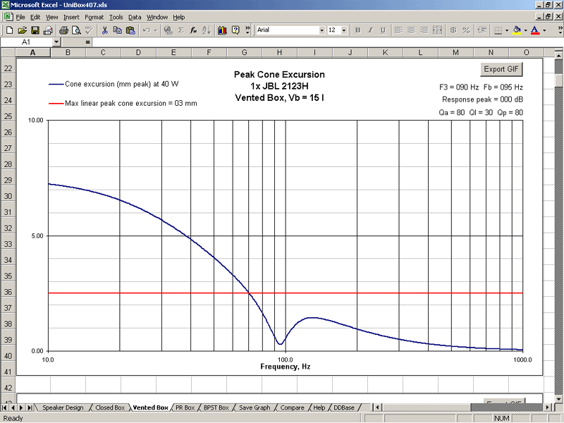

It looks as though the speaker is 3 db down at 185 Hz in the suggested sealed .5 cu/ft box. In the same box tuned to 95 Hz I am down 3 db at 95 Hz. I would require a 3" dia. port that is 1.94" long (vent moch = 0.14) or a 4" dia. port that is 4.43" long (vent moch = 0.08). Will there be an audible difference in the different port dia.?
Everything seems reasonable, I think!? I am having a little problem getting 'unibox' to work correctly.
My group delay is 6ms at 100 Hz. Is this excessive?
I have been tring to use Unibox and haven't ben able to make it work. Can anyone run the calculations for me so I can know the max wattage and db with a .55 box tuned to 95 Hz prior to reaching xmax?

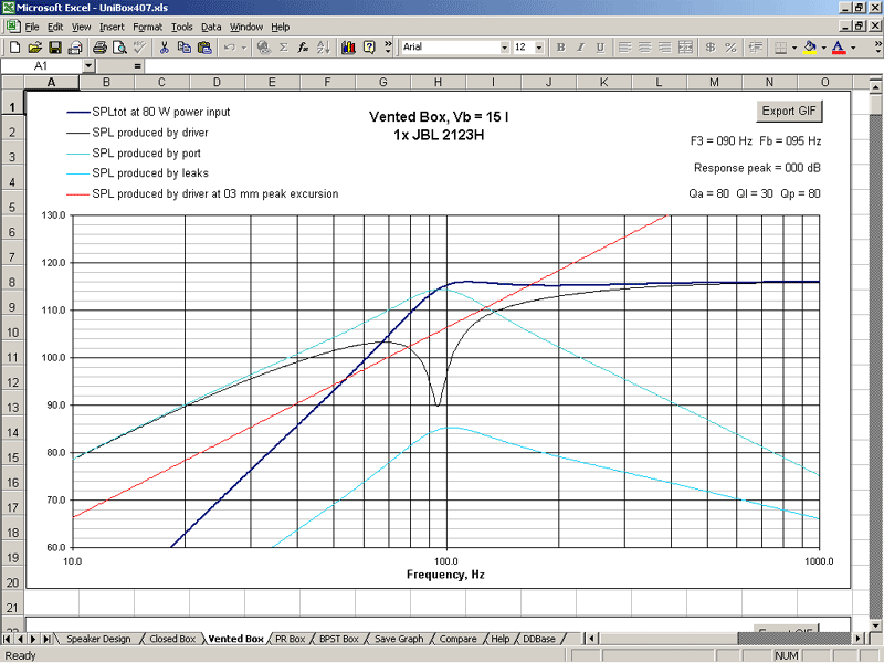

-The way I am interpreting these charts 80 watts takes the speaker to full excursion and a max SPL of 116 db. So how much power do I need to run the speakers cleanly?
-Xmax excursion occurs at 70 Hz without a crossover.
-According to the spec sheet ‘Max excursion before damage is 19mm’.What does this mean if the xmax is 2.4mm? I am a little confused.
-So with an 18db crossover at 90 Hz and tuned to 95 will I be protected from damage.
Again, I am so grateful for your help with this.
My problem with Unibox is that it will only allow me to change some of the fields.
I wrote: '-Xmax excursion occurs at 70 Hz without a crossover'.
I think that is true for 40 watts, but at 80 watts I the speaker would be approaching failure at both 120 and 85 Hz. Is this correct?

Hi
Remember total response is due to the driver + port output. That's why the total exceeds Xmax at the port tuning. Look at the ports contribution to the total on the first chart to verify.
When the driver starts to exceed Xmax = 2.4 mm the voice coil is leaving the influence of the magnetic gap. At this point IMD grows exponentially. When the driver hits Xmax damage, then the VC starts physically hitting things like the back plate.
I would be dubious of running this driver in a tuned port, unless you verify both the port and EQ filters with measurements. Notice how close the EQ has to be at the lower end of the ports output, so it will effect the total response shape.
