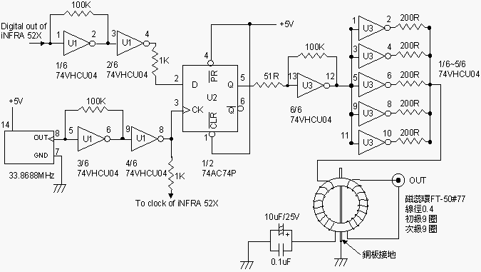

Solution to metastability issues:
Use the other flip-flop(FF) that you have on that IC.
Connect the Q output of the first FF to the D input of the second.
Take the Q output of the second FF and use this as the output.
Connect your clock signal to the clock input on both of the FF's.
This is a standard anti-metastability circuit.
Jim.
Jim.
