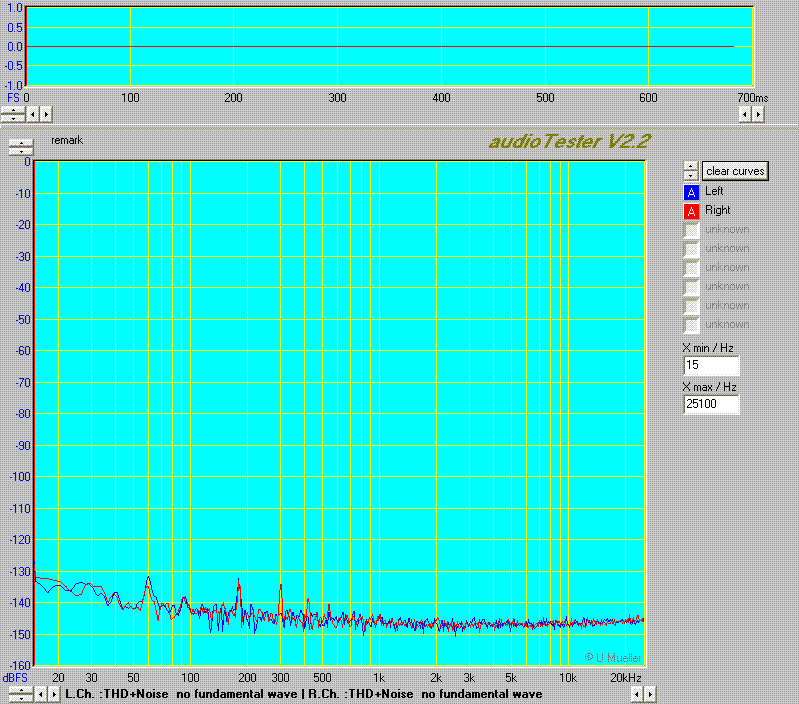

I've been using Audiotester and an M-audio audiophile 192 for a while now to do FFT analysis. I've had frequent crashes and some strange operation, especialy WRT setting different sample rates and bit depths. At present 192kHz 24-bit input seems to work fine, but I cannot get 24-bit output to work...
The FFT function seems pretty crash-free, and luckily that is what I use the most.
In an attempt to make the system more stable I recently moved the card and SW from my main office PC into a dedicated lab PC (a refurb IBM Thinkcentre that I got for ~$300). Unfortunately the software still has the same tendencies to crash, especially if you do sweep measurements. FR works most time, but THD vs. level usually crashes.
But here's the good news: The noise floor is terrific. See attached. This is close to AP territory...
So the question: Has anybody figured out why Audiotester crashes? Or am I the only one with this problem?
TIA
Pete

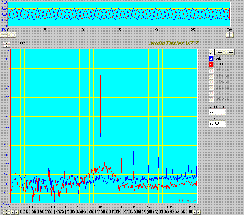

Here is the FFT capture of the M-audio output @ 16 bits, 192kHz (blue) vs. my HP 8903A (red). Still not bad...
Pete
