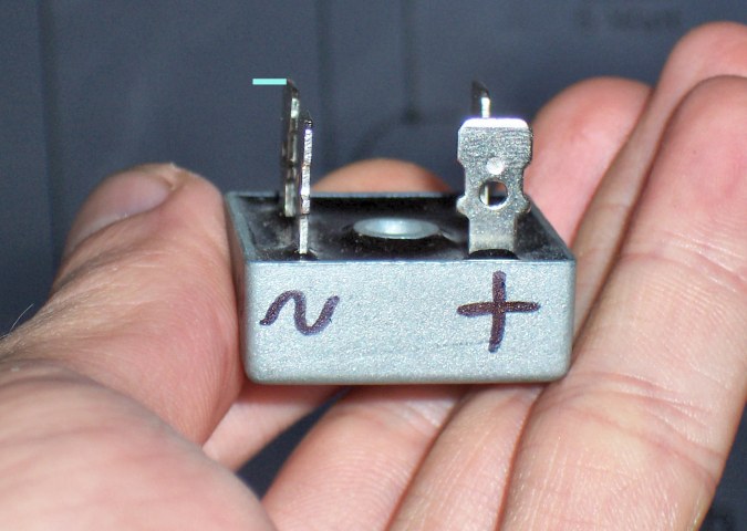

The reason that I want a photograph is that the Faston connector of the typical 35a bridge rectifier. . . doesn't match that schematic at all.
On the Faston connector, the + is marked, leaving one to assume that the - is located in the opposite diagonal corner (farthest distance away from the +).
Therefore, the schematic doesn't show a "real" unit. We need to show the real thing.
Here (click photo) is an example of a heavy duty bridge rectifier.
These are super-strong and long lasting. Some are even shielded, which is a nice bonus if you enjoy listening to your radio.
We're going to use a few, so here's a photo indicating the polarity of the larger models.
Notice: The one connector at a different angle is the +

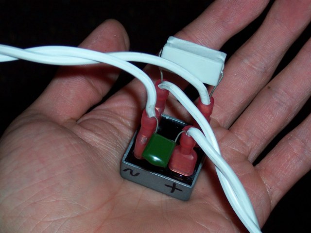

disconnecting network.
connect + to -
connect ~ to ~
connect ~ to audio ground
connect + to Safety Earth
This gives a continuous 70A rating using a 35A bridge rectifier.
It survives longer (undamaged) than it takes a T8A fuse to rupture and the arc to extinguish on 240Vac mains supply.
The optional components: 10nF to 100nF cap, 2r2 to 10r power resistor and/or power thermistor, can be soldered between any pair of adjacent spades connectors. Since one has 4 spade connectors that leaves four locations for the optional components. I use the 4th location for a low inductance/low power 10r to ensure that the impedance of the network stays fairly low at all frequencies.

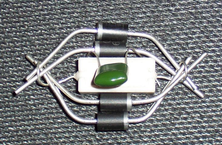

Here's the United States version for out 10 to 15 amp home circuit breakers. This can be built from parts available at Radio Shack.
Four of 6A (or better) diodes*
*Folks with fuses need the stronger UK version (above post).
A 10 ohm, 5 watt (or 10 watt) resistor
A 100nF (probably printed with "104") capacitor**
**That vendor sells the cap as 0.1uF.
And here's the photo. . .
This version is for use only if your house has 10a or 15a circuit breakers--spec for U.S. houses. Otherwise, please DO use the stronger UK model in the previous post. This weaker model was posted, because its a clear illustration.
(Click photo).

Re: disconnecting network.
AndrewT said:
connect + to -
connect ~ to ~
Okay, I think I got the message on where to connect everything except. . . the amplifier side. Considering the big UK power, I came up with this:
The most likely spot to connect, seems to be the Power Star Ground / Chassis Ground, CG, because those examples are the strongest point for connection.

Have you tested your 110Vac version yet?
Just to be clear, its specific to 120vac with 10a or 15a home circuit breakers.
Hey, and you'll notice that I doubled the number of diodes (since our previous discussion). Yes, it tests working. In my opinion, it was important to post a photo of the small version so that everyone who looks at it can understand the "visually obvious" circuit.
I'd rather that everyone use the stronger 35A UK-rated version, so I'll show that one through the remainder of the project.

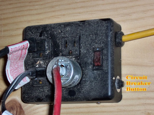

AND. . . Thanks for the reminder!! See this photo to get a close up view of this popular Carpenter's power safety device. It comes from the hardware store, and it has an inbuilt circuit breaker. (click photo)
