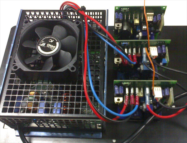

Hi.
As I saw some posts asking for switching supplies for class D modules I send you a photo of my own setup.
I am using some Hypex Ucd400 modules to power a pair of big 3-way boxes.
I have got my supply from here( I have paid 130€ for it): www.redrocksaudio.es. Actually my supply has a main output for 60+60 volts ,another one for 30+30 volts and 12+12 volts for low power aux circuits and it has PFC on input also. I am using it with 3 Ucd400 connected and it works without problem so I took away my heavy toroidal analog supply by now.

Hi:
The reasons to choose this and not the coldamp one were:
-PFC stage on input
-Better price
-No PWM control but quasi resonnant fixed frec control so less EMI radiation and noise.

Hi:
I did not find any detrimental diff. on the sound quality of the amplifiers but the lack of physical working noise from the old toroidal trafo. The only sound left is the small hiss of the Ucd400.s when idle with no sound on the inputs. The fan included has also very low noise so the only way to know that the power is on is the blue led light inside the supply and the fan blowing.
I do not have the proper equipment to measure the residual noise of the amplifiers after the upgrade but in my listening tests I could not detect it.

How is the isolation from mains to ground/secondary outputs? Is it >3KV? Do you need mains ground? In other words: is it a Class II unit.
HYPERTUNE said:
Christian:
I will order an SMPS as soon as I decide the voltage I will run on my Truepath(s).
Hi Christian,
Do you order the supply yet? Do you know if the 12V is isolated?
I'm also planning to use it on Truepath and found out that 12V need to be isolated, now I'm worried with the two units that I ordered.
NewTesla,
Is the 12V isolated?
Thanks,
Joe
Hi:
The +12V -12V connector has the common tied to ground but this can be isolated if you need eliminating a link (L2) on the pcb board.
About the isolation and safety I asked them and the supply has 3kv isolation between primary and secondary circuits and earth connector and it is a class I device using EN60065 safety regulation.
