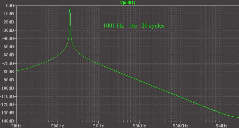

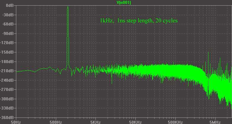

The problem is that FFT analysis always seem to give these
very-high-order overtones. They can be clearly seen when
using the spectrum analyser. Exactly the same thing happens
when using the FFT function in SPICE, where no real hardware
is involved, so I assume this is due to the FFT algortihm itself.
Although having once read through the proofs for the foundations
of FFT and convinced myself that it works, I haven't understood
FFT deep enough to figure out quite why or when these
artifacts appear. I think it is related to the ratio between
sampling frequency and fundamental frequency, but that is
just a guess from SPICE simulations.

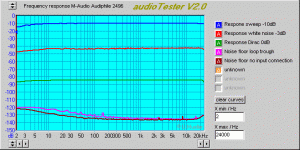

This is to show what can be done with 24bit soundcard. It is a M-Audio Audiphile 2496.
I did investigate Vic’s freeware but I could not manage it to get it working with the M-Audio sound drivers. It seems to work only with the Windows mixers and as such I can only access the Advance sound chip on my MSI main board. Here is some work to do Vic.
So for the test I used AudioTester V2.0, shareware from http://www.sumuller.de/audiotester/ This software is limited to 20 min. sessions unless you register for $18,- But it has more capabilities and does the job better IMHO. Excuse me, no offence Vic.
Attached a screenshot of the response of the soundcard. Exempt for the sine sweep response al measurements were done with averaging set at 100 times. Sampling was 48KHz en I used a Rife-Vince window for the FFT’s. It is made with a 1m loop through cable made of double screened CATV coax. The most even response is with a dirac pulse. But this has the disadvantage of its very low energy of such a pulse. It is probably not suitable to do acoustic LS measurements because of the environmental noise. Best way to this is with a synchronised MLS measurement. But I have found no freeware or low-cost shareware capable of doing such MLS measurements. So for doing LS measurements you are left with white noise or a sweep. Or buy more expensive shareware from http://www.purebits.com/ for instance (around $300).
At the noise floor there are some traces of 50Hz hum and its 150Hz harmonic entering through the loop through cable. This is something to take care of when doing measurements. Digital induced noise from the computer is virtually absent despite the card is powered from the computer PSU, a slight spur at 8 KHz and 18 KHz.

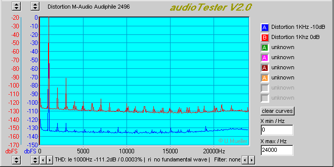

Here is a picture of the THD. THD was much lower at –10dB output then at 0dB output (card is not clipping at 0dB). I have traced down this to the buffers of the codec chip used. AudioTester takes into account up to the 9th harmonic but does not use harmonics higher than ½ Fs. You can set the harmonics to take into account by hand if you wish. The stated 0.0003% in the picture is for the –10dB signal. This is quite low and lower than can be reached with a DIY build distortion analyser IMHO. Note that I have offset both measurements for clarity, look also at the accompanying scale at the left.

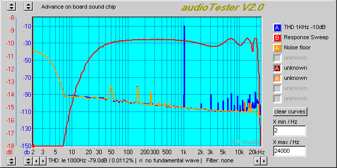

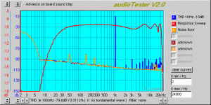

As an extra, a picture of the performance of the Advance sound chip on the main board. The loop through cable was a simple screened cable with jack plugs. Look at the considerable mains noise entering through the cable. Also there is considerable digital noise from the main board. But the frequency response is reasonable flat within 1 dB from 20 Hz to 20 KHz.
SY said:Christer, dumb question here, if I may. Do the distortion artifacts you see change if you change the frequency resolution or make a small change in the excitation frequency? I wonder if this might be a bin effect.
Not dumb at all, but difficult. I have been spending a large part
of the evening trying to do some more empirics on this. I couldn't
quite repeat the behaviour I thought I had previously
observed. Maybe it was there under some conditions, or maybe
it wasn't quite what I remembered. Anyway, the spectrum
does show a lot of harmonics all the way from the fundamental
up to 20kHz, some of them of the same magnitude as the

Whether or not this phenomenon actually did show up, I had
previously observed exactly this phenomenon when doing
FFT on Spice simulations. Since I couldn't repeat it with the
soundcard (after using the program for a few days, I have to
say there are quite a number of bugs and oddities, sometimes
making it cumbersome to use) I reverted to some experiments
with Spice. I have often used signals where the time period is
an even multiple of the simulation step length, which gives the
behaviour I mentioned. Hence, I tried to change the signal
frequency slightly, as you suggested, and that made an
enormeous difference. I made the experiments with a single
sine signal and a purely resistive load, in order to analyze
a single undistorted sine wave. That is, the only errors that
should show up in the spectrum are due to the simulation
step length and/or the FFT algorithm.
Using a 1kHz sinewave, simulating for 20 cycles with 1ns
steplength gives sharply defined peak at 1kHz with a very flat
noise floor just below -180dB, plus some low but sharply
defined peaks in the MHz area, the largest about 30dB above
the noise floor. When changing the frequency to 1001 Hz and
keeping the simulation parameters, there is no nice flat noise
floor, but a sloping one. However, the high-order peaks are
gone. Maybe the sensemorale is to use a signal period that is
not an even multiple of the simulation step length. I am not
sure if this is a phenomenon due to FFT, in which case it
can occur in measurements, or due to simulation step length,
in which case it can only occur in simulations. I attach two
spectras to illustrate this latter Spice experiment.
