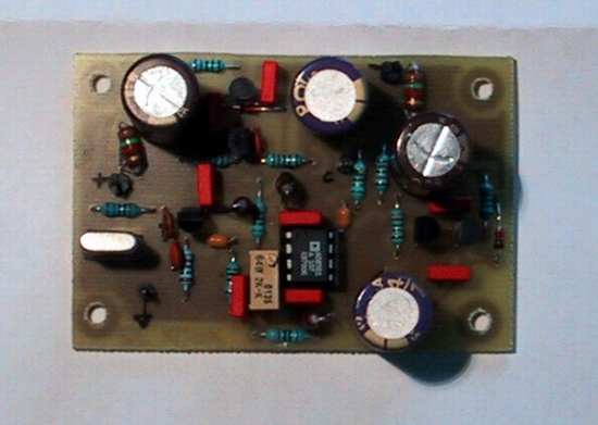

I have just recieved the schematics for the Kwak-clock.
I would like to bulid this clock, but there's a problem.
The FET used is not available from my local retailer, do anyone have a recommendation for FET I can use instead?
Can I use a bipolar transistor instead of a FET without degrade the performance?
I'm currently ordering my parts from www.elfa.se
There's also a problem with the comparator, the comparators listed at the schematic are not available from Elfa Either, but I think I have found a comparator which could work as a replacement: MAX961.
Would this comparator be a good alternative for the comparators listed at the schematics?

Hi Gunderz,
Please have a look here for all the parts I did try with less good results:
http://www.diyaudio.com/forums/showthread.php?postid=26141#post26141
and
http://www.diyaudio.com/forums/showthread.php?postid=11962#post11962
The circuit with the J309 and the AD8561 is proved and tested. With other components it might work but you are on unkwown territory.
A bipolar transistor was used in version 2 of my clock with less good results.
I doubt if the MAX961 is a good choice as it has internal hysteresis.
