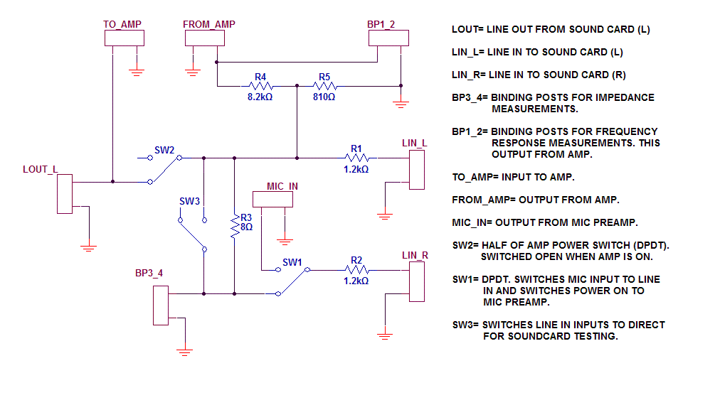

I started with the jig itself. I made some changes that, to me, made sense. I eliminated the 4/16 ohm calibration resistors and with it the switch that puts these in and out of the circuit. I also deleted the clamping zeners as these are a potential source for distortion.
I established a voltage divider for the amplified signal which will protect the sound card from the amp.
I made the switches more "friendly", with just 2 on the front panel for jig function: direct SW3 (puts the jig in loop back for sound card calibration) and frequency response/impedance measure SW1.
The power switch for the amp (SW2) also cuts the line out from line in, allowing all of the connection cables between the jig and the sound card to remain in place.

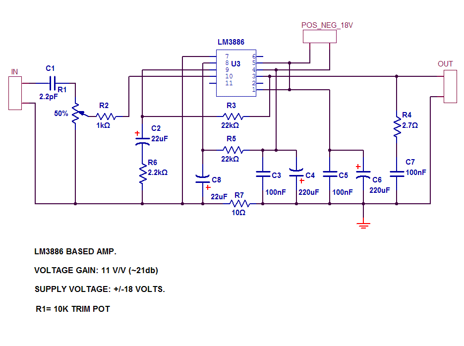

I wanted to make the amp for frequency response testing as compact and simple as possible. I used the same circuit design I've used for other chip amps I've built, but I reduced the supply voltage to +/-18 V and reduced the gain to 11 V/V. Typically, this amp will only supply a watt or two in most instances.
By keeping the supply voltage low, I could use smaller 25 V electrolytic, making the board layout as compact as possible. Making the board double sided, I created pads on the top copper and on the bottom copper to surface mount the leads of the LM3886, rather than thru hole mounting. This allows for wider traces in a more compact layout.
Here's the schematic for the amp:

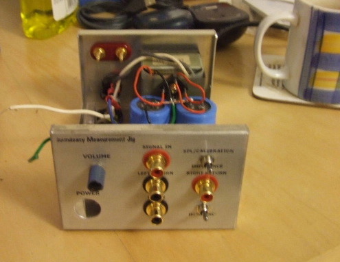

That is very professional looking Al. How much more work do you need to do on it? What did you use for the front panel labeling?
On mine, I tried to use the laser print transfer method, but it kind of smeared (I'll post a pic later).

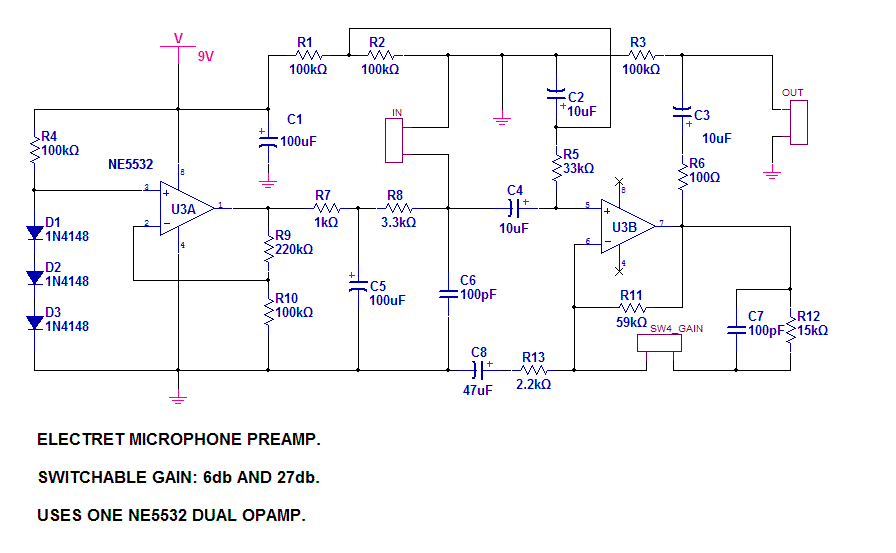

For the mic preamp, I used Eric Wallin's design, but made some changes. Having built the preamp before, I know how well it works - low noise and efficient. A 9 volt battery lasts a long time.
I used the NE5532 for the opamp. This opamp is as good as they get IMO.
No major changes to the circuit, other than eliminating the clipping indicator. Test that I made during the construction of this preamp show clipping to be well above the practical input level.
In the original design, the gain is selectable between 2 and 20. I found the low gain useless - I never used it as the output was not enough. Likewise, the high gain seems just adequate sometimes so I went ahead and changed that, increasing the gain to ~7 and 27 for low and high.

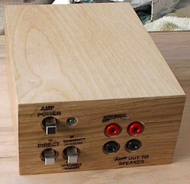

John, it is indeed toner transfer.
Hi Al,
My trouble started when I tried to print the labels in a mirror image. For some stupid reason, my printer (HP 3050) software doesn't support it, so I had to improvise. I used MS Word to type the words on the screen, then did a screen capture to the clipboard. Pasted this to Paint and reverse and resized the type.
A genuine pain in the ****.
There must be a better way.
Then, the front panel on mine is solid white oak. I sanded this as smooth as I could get it, but it still has open grain.
I can't say I'm thrilled with the results, but it's good enough for what it is and as long as I can read it, it'll be fine.
Here's a pic of the final finished product. Overall dimensions are 3" high, 5 1/2" wide and 7 1/2" deep. Jacks for sound card connection, mic input, power mains input and a switch for mic gain are on the back (more pics to come).
This morning I added a "power on" LED for the mic preamp. This will remind me to turn it off :)

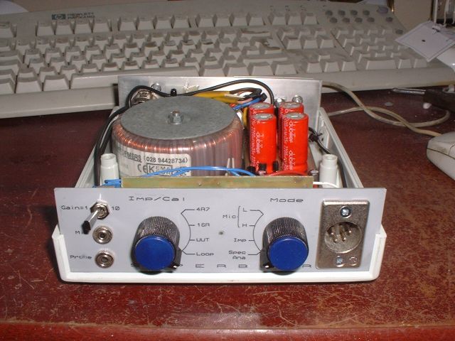

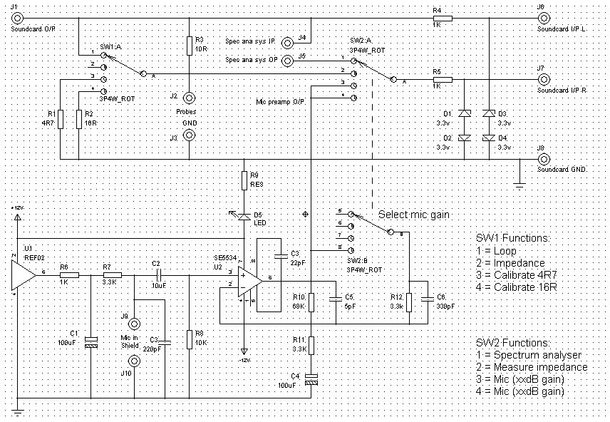

The attached pic is my take on the all-in-one Speaker Workshop jig. It contains an L165V chip amp, my own design mic pre-amp and all the signal switching of the Wallin jig but compressed onto two rotary switches. I've also added a spectrum analyser function for measuring the frequency response of active crossovers and the like.
I'm currently in the process of redesigning the jig - squeezing it into such a small case meant some compromise needed to be made. Swapping the ghastly L165V power op-amp for a LM3886 is on the agenda as is improving signal routing.

One thought that just occurred to me: A higher chipamp gain than 11 V/V might give better performance. If so, you could just put a resistive divider before the input, and keep the overall gain wherever you want it.

Very Nice! The rotary switches are the best choice or extra functionality. I should have considered it (next time :) ).
The spectrum analyzer is PC based?

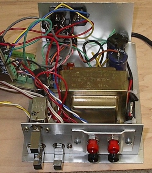

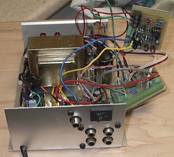

Here is a shot of the guts of mine from behind. The amp, preamp and jig are all on separate boards, connected together via terminal blocks. Makes for a bit of a snakes nest, but gives more flexibility in squeezing everything in.
The LM3886 amp is attached to the bottom aluminum plate, which serves as the heatsink.
Hi Tom,
I don't think there's a drop in performance with the gain at 11. The minimum (for stability) is 10. I did some squarewave testing on the completed amp (with a 4 ohm coax speaker as load) and it runs beautifully.

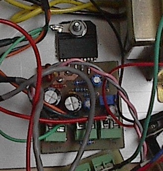

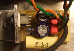

Here's an up close shot of the amp board. notice how the leads from the LM3886 are surface mount on the top and bottom of the board.

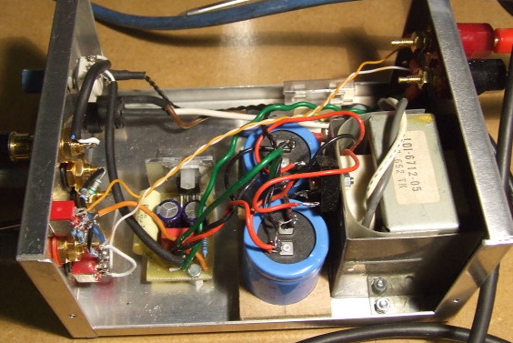

Hi Al,
Any specific reason why you used the OPA548? I haven't looked closely at the specs, but it's about $11 from Digikey here, almost twice the cost of the LM3886. I had some spares (with short leads - cut off of my active amp boards), so no cost for me really. How's the performance of the OPA stack up to the LM? Or is it more like my situation - as in "this is what I have"
I'm impressed with the LM3886 though, not only sound quality wise: I etched the board, looked it over then populated it. Looked it over again and fired it up on the +/-18 V supply. It didn't sound right, too low and distorted. It turns out there was a tiny copper bridge from the output to the negative rail.
This abuse :eek: , coupled with the previous abuse I heaped upon it in the active amp board fiasco, tells me these are tough little customers. With that said, I doubt it would have survived a higher rail voltage, say +/-35. I need to break out the old magnifying glass. :).
A full frontal view, nude. I wanted to make it so that everything was attached to the sub chassis, and the cover would slide on over it all. Complicates construction a bit, but makes it easier to put together and work on in the future. There's an abundance of recycled parts, gleaned from old receivers and other low dollar "finds".

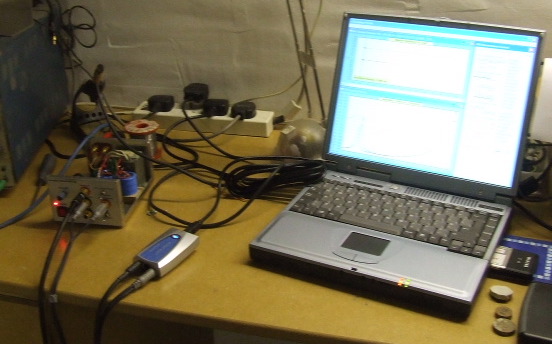

What sound card are you using? I had an old Thinkpad 780ed that I tried before with an Audigy PCMCIA card, but it wouldn't work - processor wasn't fast enough (PII, 266MHz). I gave up on that and switched to a desktop, but I'm having issues with that too (see below)

I'm now having computer problems. The computer I have been using is an 8 year old P3 1Ghz. Integrated audio has one functional channel, and the Soundblaster card that I originally put in there 6 years ago is burned out (I did it - overloaded it using RMAA to test an amp).
Now the replacement soundcard, Audigy 2 SE, was working ok for a while but with some glitches. Random restarts, BSOD, freeze ups. A driver issue, most likely. I bring the computer up here for internet access (none in my "lab") to find some drivers.
I discover the chipset, Via VT82C686A has an audio problem, that was never resolved by Via. In the installation troubleshooter for the new Audigy, it specifically singles out this chipset.
Long story short, I'm looking for another socket 370 motherboard. I see several on Ebay, a particularly nice on is the Intel D815EEA.
My unit is fully functonal and works like a charm. I had it up here connected to my real computer and everything looks good.
Here's my (not working) lab setup:
