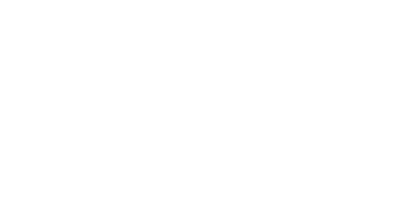

Even if they have probably been around for a long time, I recently got acquainted with TL783 regulators.
Has anyone used to good effect?
My concern here is for how they can influence audio quality, when compared with other types like 3X7 types or LT1085/1033.
To start with their impedance is a bit worst than the 3X7 types, as you can see on the graphs below, the 783's being on the right.
On the other side they look ideal to use as voltage regulators in low current stages in a power amp. Opinions?

These curves shows the output impedance with a rather "naked" regulator. If you add caps you will get lower impedance but your step response will probely be worse but if you have a rather constant load, this doesn't matter so much. One trick can be that you add a small resistor (1-10 ohms) between the load and the regulator, then you can add caps as many you want.

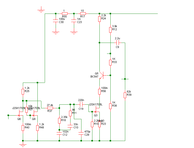

I do this in the front-end of my JFET phonostage. The circuit my even be on the breadboard right now, but as I have too many little projects going on right now, this one is dormant.
Sorry for the crappy schematic quality, but Q9 is the FET doing the trick.
