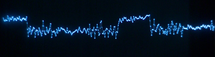

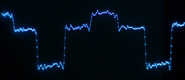

Analyzer with 500mV full scale and 40x preamp:
PCM56 8x os Yamaha CDX-5000 good adjusted MSB track 15
PCM56 8x os very bad adjusted MSB track 15
I measured also PCM63, less noise but no better linearity.

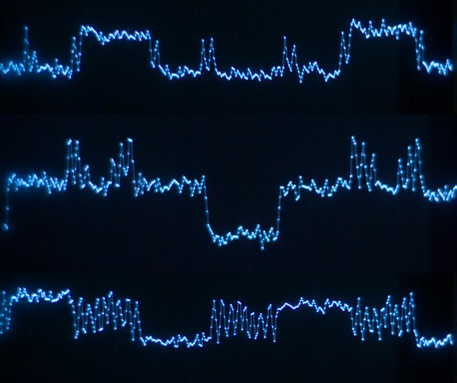

TDA1541 4x os Philips CD960 MSB track 15
TDA1541 bad bits ( various tracks )
It also has a few good ones

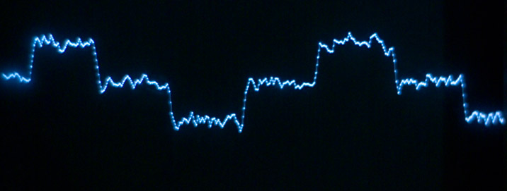

It should look like in my first picture.
Tracks are bit n switched on, +1/0/- 1 LSB

oshifis said:Wow, that's better than I expected! What kind of analyzer are you using? My scope has 5 mV/div sensitivity and I can't see anything but noise. I have no preamp yet.
The analyzer plugin has 14 bit resolution and 1V vertical full screen sensitivity ( 500mV 0p ), the gain should be 400x, two cascaded 20x channels ( big error in other posting ) but it is 1470, so it is good visible.

Finally I built a x100 preamplifier (NE5534AN) with sufficient low noise and hum-free. The DAC still produces some switching artifacts so that the signal line is vertically wide, but the levels are clearly seen. On bit 12 I have seen the same problem as on the last trace of Bernhard (TDA1541A bad bits) and some higher order bits are not very nice, either.
