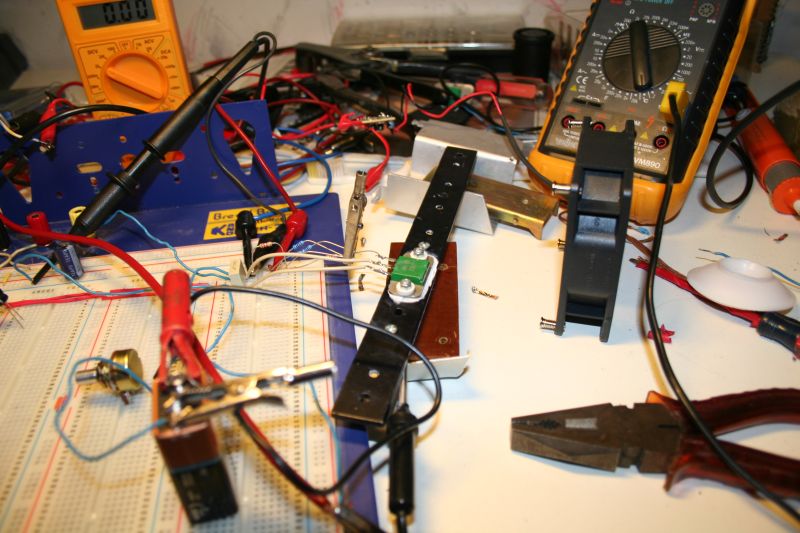

I did a fun little experiment with a Hitachi 2SJ83 lateral mosfet a couple of weeks ago. It is probably the same die as used in the 2SJ50, the parameters in the datasheet look the same.
Mounted on the small "heatsink" (~4degK/W) shown in the picture I gave it 50V drain to source and then applied 10V to the gate with a 330 ohm gate resistor to suppress oscillation. The current after a short short while was 6A. (300W dissipation in the 100W rated part) The fan in the picture was NOT running.

I didn't have any fast responding instruments for measuring the current, I just used the ones on the power supply. So it's 6A after maybe 0.2 seconds or something. The initial current might have been greater, but the laterals conduct less current at the same Vgs the hotter they get...

Glowing orange and still behaving as an amplifier? :hot: I'm not surprised it didn't work afterwards though! The lateral mosfet in my experiment does something interesting though:
The device under test is a lateral mosfet, a Hitachi 2SJ83, a 2SJ50 equivalent in a weird plastic package. It is mounted on the small "heatsink" (~4degK/W) shown in the picture in the first post. I gave it 50V drain to source and then applied 10V to the gate with a 330 ohm gate resistor to suppress oscillation. The current after about 0.1 seconds was 6A. (300W dissipation in the 100W rated part) The fan in the picture was NOT running.
The current starts decreasing very rapidly, maybe to 2 amps after a second. (the current has a negative temperature coefficient above 100mA) The heatsink continues to heat up. This negative temperature coefficient is not enough to limit the temperature much though due to de woefully inadequate heatsink. :D
Next, the FET starts to draw current into the gate, thereby lowering the current through it and the dissipation. When the current going into the gate exceeded 8mA a small pop was heard, the gate voltage dropped to 1.2V (drawing 25mA then), the drain current dropped to 0.2A and the heatsink started cooling off. After turning off the drain-source power supply the gate was still drawing current.
By turning off the gate supply the transistor stops drawing gate current of course, but when turning on the gate supply it doesn't draw any current. :confused: Maybe it wasn't destroyed? I did the same experiment a couple of times, and it does the same thing each time :eek:
If I drop the gate voltage so the gate current never exceeds 8mA I can get the heatsink to stabilize at 165 degrees celsius with 40W of power dissipation. The transistor is mounted without insulating washer and the temperature is measured right below it so the die temperature seems to never want to exceed 200 degrees by much.
It is interesting that it has this built-in overtemperature protection, no wonder they got the reputation of being rugged and outlasting fuses! But I wonder, what is it that causes this? Is it something with the built-in gate protection zeners maybe? The thyristor effect when exceeding 8mA of gate current is very interesting :confused:
