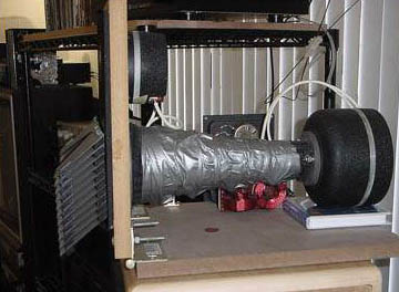

Hi Arne,
You don’t have to split the filter. This is what I would do. Make a new or get a used xover between the LE-85’s and the 077’s and run the woofer right from the amp. I would run a electronic xover for the woofer to horn transition, but you don’t have to.
Cross the LE-85 to the 077’s at about 8kHz or higher if possible. You can frequently find N7000 xovers on ebay, but the N8000 is kind of rare. It may be easier just to make a new xover with premium parts. If you don’t use the premium parts, at least bi-pass the cap with good audio grade caps.
Cover the baffle around the mid-horn and the 077’s with 7mm foam or felt (remove the lens first so the foam goes right to the edge of the horn). Cut strips of the same foam and wedge them between the fins on the rear of the lens, but not more then 10mm in from the back edge. There should be a round area open to the horn mouth. This will help to control any baffle diffraction as the sound wave travels through the lens. Wrap the mid-horn very tightly with some heavy rubber or neoprene. You can use large wire ties to hold the rubber tight around the horn, the more the better.
In the photo, you can see the foam on the baffle and wedged into the back of the fins. You can also see the N7000 which I totally rebuilt with Solen coils and caps. I may eventually replace the L-Pad with fixed value Caddocks.
Email me if you have any questions.
