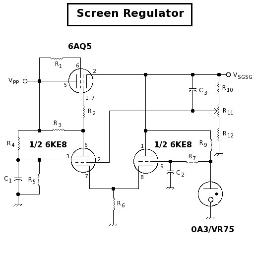

A further aid to sonic improvement is an active screen voltage regulator. Stable screen voltage and a Lo-Z screen source helps to improve the sonics of any pentode final. The screen regulator is based on the 6KE8 (another TV t00b) which combines a high gain pentode (error amp) with a medium gain triode, both connected in an unbalanced differential stage. Reference voltage comes from a 0A3/VR75 gas discharge regulator tube. The series pass element is a trioded 6AQ5. This regulator holds the screen voltage rock steady regardless of the volume.

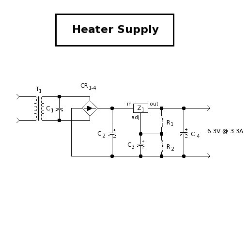

Heater Supply
The heaters run off a DC supply, based on the FAN1084 integrated voltage regulator. This is a floating supply to protect the heater/cathode of the 6FQ7 since the negative rail comes up before the heaters get a chance to warm up. This could cause a flash-over since the Vhk rating isn't nearly that high.
DC on the heaters also helps to keep the amp quiet.

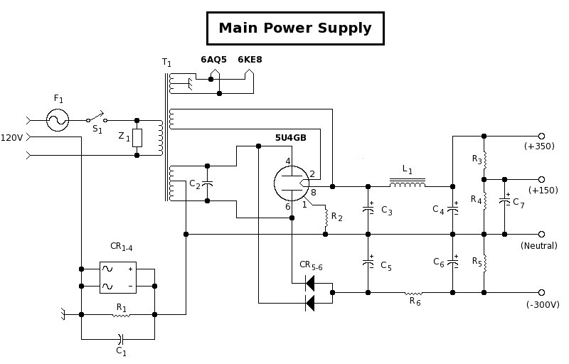

Miles Prower said:Since Image Shack isn't being very cooperative today, I'll try attaching the schemos for the main power supply and the screen regulator here.
Main Power Supply
Hey Miles,
One possibly dumb question.. Why the Resistor from pin 1 of the 5U4 to ground,isn't pin 1 N/C?
DigitalJunkie said:Hey Miles,
For this particular application, pin 1 can probably remain floating with no problems. However, it is a connection that discharges static charges that can build up when the 5U4 is used with TV sets where there's the voltage from the CRT HV supply. It's discharged via a 1M resistor. The voltages used here aren't that extreme, but keep it in mind if you get the occasional flash between plates, or from plate to filament. We are coming up on static electricity season here.
