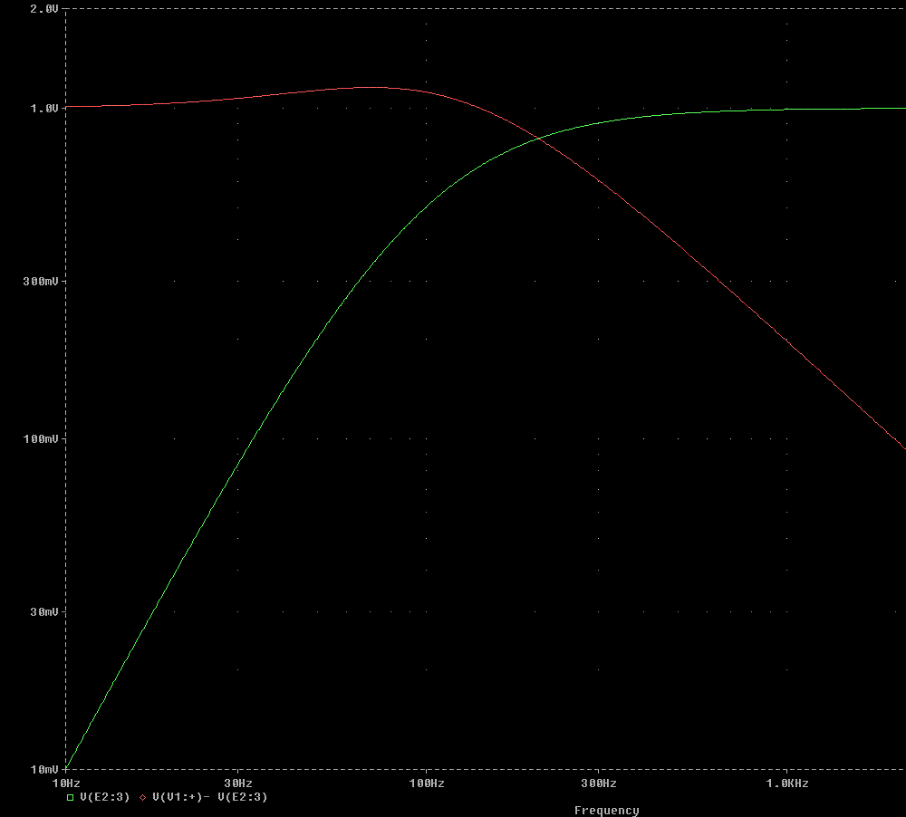

What we do to begin with is taking the response of the aforementioned subtractive crossover. As highpass function we take a 2nd order filter with a Q of 0.5. The actual crossover frequency wouldn’t be the pole frequency (where there is already a 6 dB drop compared to 3 dB for the Butterworth case) but about one octave higher. Both drivers are down by about two dB at the crossover frequency. For higher-order filters the relative level at the crossover point might be higher than 1 - just to mention one of the disadvantages of higher order subtractive crossovers.
So the original transfer function we are going to use will be:
H(s) = (1 + sT/0.5 + s^2*T^2) / (1 + sT/0.5 + s^2*T^2 )
This is then split into two parts:
H(s) = (1 + sT/0.5 ) / (1 + sT/0.5 + s^2*T^2 ) + s^2*T^2 / (1 + sT/0.5 + s^2*T^2 )
Giving the highpass function
Hh(s) = s^2*T^2 / (1 + sT/0.5 + s^2*T^2 )
And the lowpass function
Hl(s) = (1 + 2*sT) / (1 + sT/0.5 + s^2*T^2 )
As one can see the lowpass section is actually the sum of a 2nd order bandpass and a 2nd order lowpass. That’s where the 1st order slope and the hump of the lowpass come from. Another method to generate this transfer function is to multiply a 2nd order lowpass with the sum of unitiy gain and the output of a differentiator. It is the latter that we are going to do.
Enclosed you see the simulated responses of the topology we are going to approximate. It is shown for a highpass pole-frequency of 100 Hz.
More to come !!

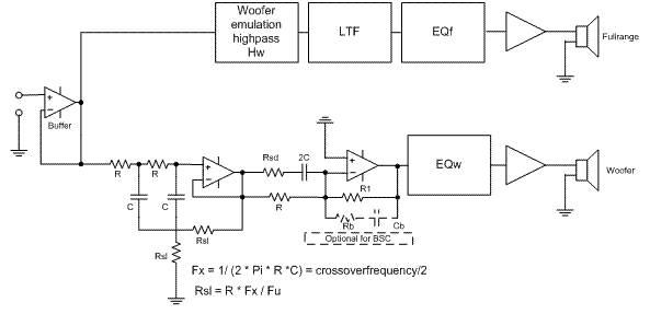

The drivers one is going to use should be reasonably well behaved within their passband. Irregularities and baffle-step should be EQed out. This is shown as EQw and EQf. The woofer should at least be usable up to about 5 to 10 times the crossover frequency.
The 2nd order highpass function for the fullrange is achieved by simply using an LTF in order to push the pole-frequency upwards to the pole-frequency fx and achieve a Qtc of 0.5.
There are two problems that remain: 1) There is not much protection at the low end (though still a big improvement over real fullrange usage) and 2.) the phase-shift of the woofer can play havoc with proper SPL summation.
A simple and effective means for 2.) is the use of a highpass filter Hw in the fullrange branch that mimics the low-end response of the woofer and that also intrinsically improves 1.). For a closed box this would be a 2nd order highpass and for a reflex box a 4th order highpass respectively.
Though I am not sure if one wants to use a reflex box for a “transient-perfect” loudspeaker ! ;)
A little more complicated is the situation for the woofer.
As already mentioned we can achieve the required lowpass transfer function with a 2nd order lowpass, a summing stage and a differentiator.
But when doing this we have to take the woofer’s upper frequency limit Fu into consideration. We do therefore truncate the lowpass function at the upper frequency limit of the woofer by the use of the two resistors Rsl. This is of course only an approximation but it is better than doing nothing at all. The best thing would be to use a dual gang pot for these when experimenting. It can then be replaced by fixed resistors later on. Also R can be substituted by a dual gang pot during fine-tuning of the circuit.
The differentiator function does have to be truncated as well - otherwise we run the risk that this crossover branch has very high gain at high frequencies. This is done at a frequency between 10 and 30 times the crossover frequency by the use of Rsd (and therefore chose Rsd 10 to 30 times smaller than R).
The other reason not to try to achieve 1st order behaviour of the woofer/xover combination up to infinity: The fullrange driver’s response starts to fall off at a finite frequency and we would not want the woofer to try to compete with the HF response of the fullrange !!!
The differentiator’s feedback path can be used for gain setting with R1 and/or baffle step correction if needed.
The circuit presented may not give the flattest possible response (and the formulae are only coarse approximations) but it is one of the cheapest entry tickets to the world of transient-perfect loudspeakers.
Enclosed you’ll see the block diagram:

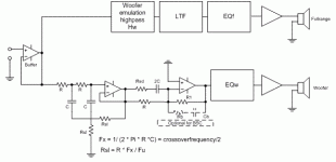

I fail to see how adding to the high bass roll-off of the fullrange
with additional high pass filters would help, surely the phase
shifts would be made worse.
No wait a minute, perhaps your really do mean the woofers alignment
being applied to the FR, but that runs into the rather serious problem
of the FR's own bass alignment well before you get to the woofers.
You would need to LT the FR to the woofers alignment, and
that is no recipe for improving its protection at the low end.
I guess it depends on the two drivers in the FAST and the
x/o frequency, but it doesn't strike me as a general way
of doing things for all combinations of FAST drivers.
rgds, sreten.
You don't LT the FR to the woofer's alignment. You LT the FR to the desired acoustical highpass slipe that you want to target. You then add another highpass filter to the FR in order to add the same phase-shift as the woofer to to the FRs (out of band) response and at the same you increase protection at those frequencies.
In some cases you might simply use the FRs natural rolloff as acoustical crossover, sometimes you would need a parametricc EQ for lowering the Qtc to 0.5. Each case has to be looked at separately. And there are cases where it simply wouldn't work.

In the schematics you can see how the baffle-step correction can be included in the feedback path of the woofer xover. For the FR this has to be added in one of the known fashions. And yes - it will further take something away from the steepnes of the achievable highpass but that's how life is. With the FR driver (Manger) that I used I could do without BS correction on the FR because it has a rising response towards the lower end which can be abused for BSC.
If a third-order highpass function was called for I can do the maths as well but be aware that this would mean some more overlap in the XOVER area.

You effectively do, and then add the required filter function,
not necessarily in that order. You are clearly describing the
the high pass functions of both drivers being the same
without the x/o slopes.
I will have to re-read the "old part" because it wasn't meant that way but maybe I was unclear with what I wrote.
What I basically did was "building" a 2nd order highpass using EQing of the FRs natural low-end response as the highpass part of the crossover. It is clear that this works much better if the EQed response has a higher cutoff frequency than the natural response of the FR than vice-versa.
The next step was to build a transfer function that approximates the lowpass function of the subtractive crossover and at the same time taking into consideration the woofer's non-idealities at its upper end to some degree.
The third step was to add the woofer's phase response to the FR by the use of a highpass filter. This is admittedly taking place at a frequency range where the FR doesn't contribute to total SPL that much anymore but it would still be contributing in a undesirable fashion du to taking place quite close to the xover frequency. This highpass would not even have to be a very exact replica of the woofer response. And in some cases it might be done by dimensioning some coupling caps accordingly.
