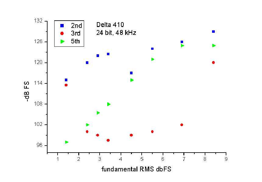

Ok, and here's the results:
- on the horizontal axis the level of the 1 kHz fundamental is given, and the fundamental was varied over a 7 dB range for these experiments
- on the vertical axis you can see the level of the 2nd, 3rd and 5th harmonics relative to full scale (all other harmonics were at -125 dB or below and disappered in the noise floor most of the time)
- as the fundamental is increased 7 dB, the 2nd harmonic increases 14 db - nothing surprising here, it just indicates you would not use the card at or near full scale if you are comfortable with the noise
- over the same range of the fundamental, the 5th harmonic increases 27 dB - this is expected, as a 5th harmonic is associated with a stronger nonlinearity
- however, the 3rd harmonic shows a sharper increase than the 5th for the initial 1 - 2 dB of signal level, then shows a very shallow increase for the next 3 dB only to improve markedly on the final 2 dB - this is very surprising, and the only handwaiving answer I could come up with is that somehow nonlinear effects in the DAC and ADC are compensating each other for part of the range
