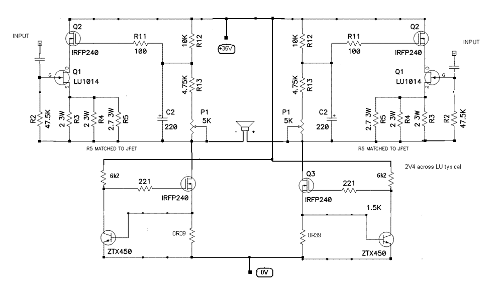

GRollins said:Good start. You might want to ground reference the Gates of the LU1014Ds.
Grey
even if I lost my greeny button this days............ for balanced signal- you don't need that ;
for unbalanced - input gnd is on +35 .
or should I draw that tiny gnd symbol..................
steenoe said:That looks unusual! How many watts do you expect to get out of that, 30-40?
Make that: It looks very unusual and interesting Easy to build too.
Steen
naah.
green button missing; brain is in red

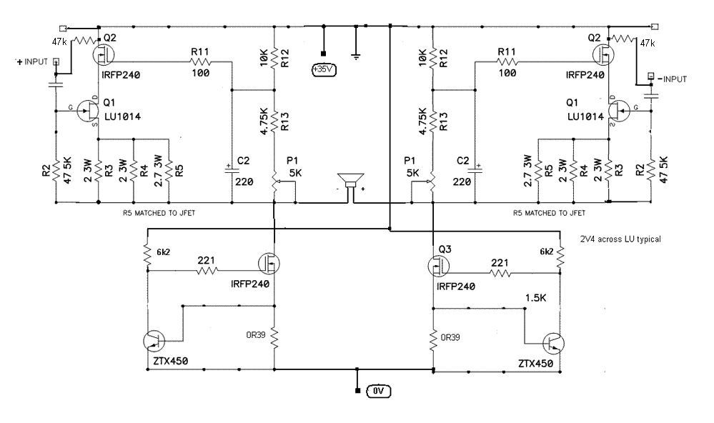

another one- familiar to you?
edit - I know that pic from post 1 need few additional lines,too....... but not tonight........

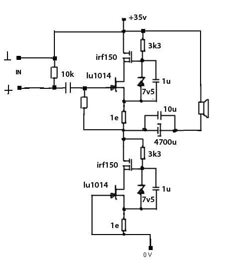

Zen Mod said:
naah.
Sure, thats Patricks sweet little headphone amp, alike
Ohh, just want to add, the sound comes cleanly through Patricks LU HP-amp!! Very clean!
Zen Mod said:
difference?
From start: Higher railvoltage, a lot more bias, more current capable cascode fets and a lot different input, which I dont quite get! You have added a DC blocking cap at the output too!
steenoe said:
................. and a lot different input, which I dont quite get! You have added a DC blocking cap at the output too!
follower is in the name of the thread
just compare this and Pat's shematic ;
where is outer side of spk connected..........
in other words where are grounds and what electrode ( hehehehe) of active device is "grounded"
Let me have a go and see whether I will make a fool of myself.
The first schematics is a balanced version, one half of which you then drew in the second schematics. Since it is balanced, the speaker is not referred to ground (or positive rail). But I do not see any advantage in using a single rail and input caps.
(Matter of taste I guess. I don't like caps in the signal path).
For me, if I want to do a balanced follower, I'd rather use 2 cascoded JFET in a circlotron follower (see Grey's Newtron thread or many other circuits from Tubecad). Direct coupled, bandwidth from DC to way over 300 kHz, 4 transistors (same number as the DAO follower but half the output impedance and twice the current driving capability). You can even easily modified the DAO PCB for that. DC drift problem, if any, is the same as the DAO.

And Steen, if you want more bias from the DAO, you just change the source resistor to 0R68, like in ZV9. Parallel that a few times, and you get a power amp to compete against the F4. If your speaker is not low impedance, I think the input capacitance would not be too much of a problem, since it is a source follower, and on top of that you have further reduction of effective Cgd due to cascoding.

steen - try to rearrange your hdphone amp to input and output like this (second ) schematic ,and say what you hear.......
