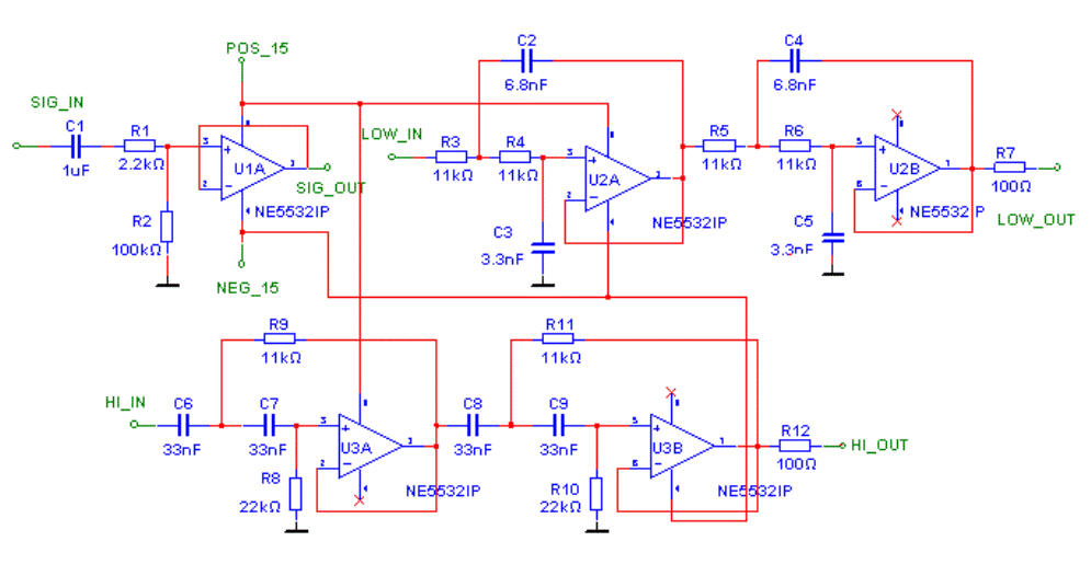

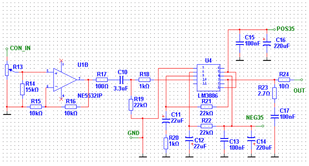

I have adapted Rod Elliot's P09 24 dB/octave filter and used his implementation of the LM3886 (P19). I have come up with the following schematics, the first is the filter section.
Thoughts and comments either positive or negative are welcome. I want this to work right the first time.:)

if you can arrange the components R3 & 4 and C2 & 3 to fit a DIL header and arrange the PCB with a DIL socket, you can swap out different headers with alternative frequencies and or Q values.
You can also swap C for R in each header by simply turning it around to convert from low pass to high pass (but this screws up the Q if you go for unity gain filter topology). If you go for equal value S&K then Q is set by the opamp gain and the Rs&Cs control just the frequency and not the Q.
This arrangement is very easy to change and saves a lot of PCB space by avoiding the need for the extra dual opamp and it's components.
Have you read the filter threads for the previous group buys? There is a lot more than just turn-over frequency and slope to consider when activating your drivers.

Keep in mind that the LM3886 is itself an op-amp so you can wrap a 2nd order filter around it and eliminate an op-amp -- the fewer the better... with a little finessing you should be able to build a 3rd order filter around the power op amp....
dave
Excellent idea Dave, I hadn't thought of using it.
The other filter sections are unity gain, the amps at 27dB gain - any adverse effects?
Another good idea. The use of sockets would vastly simplify the "tuning" process. The component values in the schematic are not the actual ones I will use, as I haven't determined the ideal crossover frequencies yet.
I want the board as simple as possible though, with the shortest runs and single sided. The DIP sockets might mean a lot of re-routing to accommodate.

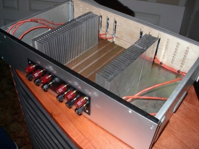

I have started to build a new chassis that will house the power supply seperately, along with the power supply for my sub amp and anything else I wish to add in the future. It will have:
1/ 50-0-50 800VA (+-70V)
1/ 30-0-30 300VA (+-42V)
2/ 25-0-25 120VA (+-35V)
1/ 12.6-0-12.6 60VA (+-15V regulated)
In the chassis will be the bridges and filter caps. Also should have a soft start circuit capable of handling 1500VA.
Pic of partially complete power supply chassis:

The ones that I've built were LR4 @ 100 and 2k, modified from Siegfried Linkwitz's phoenix xover. A few things came to mind about your design:
- baffle step compensation
- use lm6172 or opa2132 opamp instead of NE5532, and include PSU cap bypasses from +ve to ground, -ve to ground, and +v to -ve
A question though about your schematics which show LP 300 and HP 3k, were you also intending to add LP300 + HP 3k for the midrange drivers in the 3-way?
Hi Trats
My approach is to have pots to adjust the levels of all six channels, so that will cover baffle step (increase output to woofer)
The op-amps I have, so I'll stick with them. The NE5532 is good enough for this application anyhow - low noise.
Bypass to ground on both rails are in place (C13-C16) Could put one from rail to rail, say .1uF.
The values shown are temporary, as I haven't determined the optimal crossover freqs yet. The plan is for this to be modular,each board will be a self contained filter and amp for a driver. For example: the woofer will be driven by one with only the low-pass components on it. The midrange will use both high-pass and low-pass.

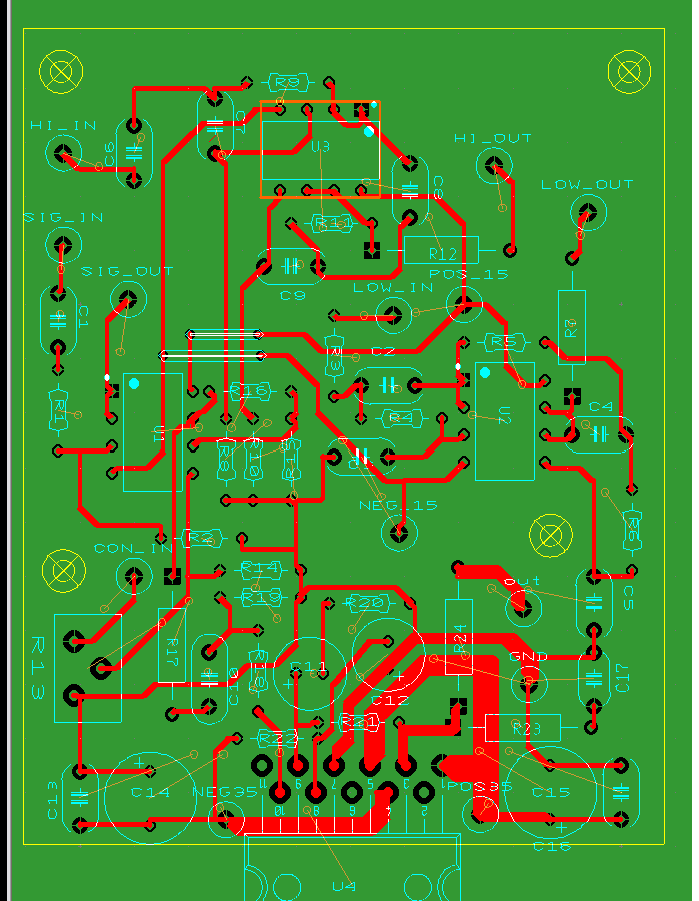

A sample board layout, based on the schemetics posted earlier. Something I did before I started this thread to figure out the board size. Took a while to figure out how to get it to a postable format.
One sided, just 2 jumpers. Finished board is 2.5" x 3" which is the perfect size forthe chassis I've built.
Once again - thoughts, comments, like it, hate it, or just don't care. It would be nice for some of you out there to look it over with a critcal eye, point out my mistakes.
Like I said earlier, I want this right the first time.

Hi John. You could compact the layout a bit, unless you find it harder to work on a board with closely spaced components. Also, since each of the 2 op amp filter blocks (high pass and low pass) have the same basic component configuration (just with R's and C's switched) you could come up with one good, compact layout of that block and then copy it twice. It's also considered good practice to have your connections/wiring points on one side of the board, but certainly not necessary. I do like the way you used separate pos_15 traces going to each op amp V+ pin. You should try to do the same for the neg_15 traces. Grounding is also suboptimal because you chose to do a single layer board. Have you thought about using a double layer board? You could use one side as a ground place and the other for the traces. It will be trickier etching that yourself though, but probably worth the extra effort.

I'm working on a new layout, one that will increase the ground coverage, as well as widen the positive and negitive traces, and generally tidy things up.
I won't be etching these myself. I have found a place that will produce these boards for $15 setup plus $3.50/board. No silkscreen, but I can take care of that.

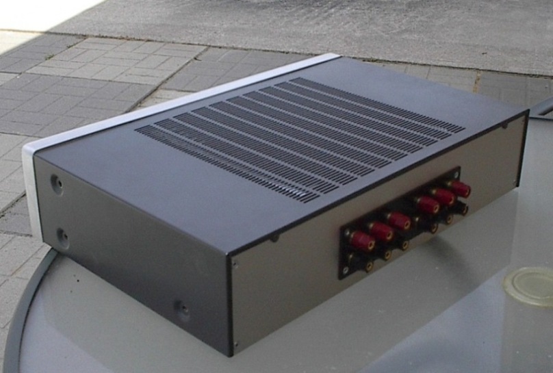

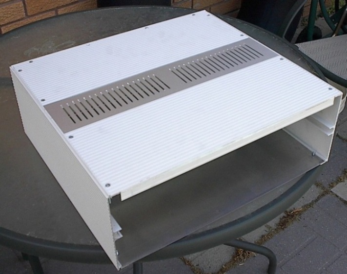

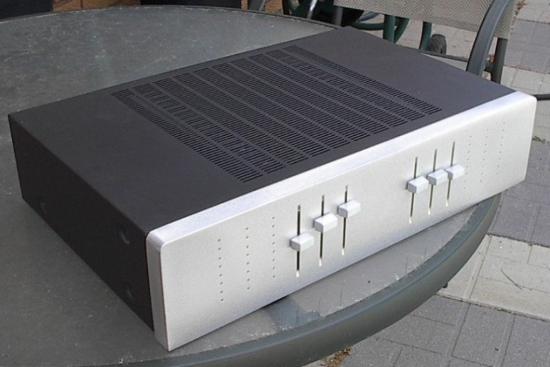

In the meantime, I have finished the chassis, except the power inlet (which I'm still working on).
Here's a couple pics, front:
