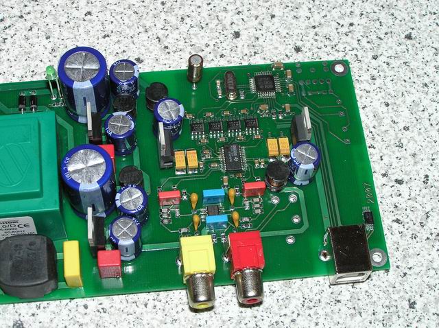

Look at this specific USB DAC, I already mentioned aboit it. It has separate power supply, galvanic isolation from PC and preatty good sound. w/o box it costs only 75USD. I sink it's a good solution for deck PC audio. For mobile 230V reqirement is troble.

USB 1.1 used for DAC = not that great an idea as the best it can do is 16 bit/44k or 16bit/48k audio.
USB 2.0 used for DAC is much, much better = 24 bit/48k or 24bit/98k (in many cases).
USB 2.0 extensions = http://industrialcomponent.com/vigor/vactive.html . or . http://industrialcomponent.com/bafo/bf3000.html ... these share the same USB hub chip, BUT either will "handshake" and degrade potential USB 2.0 performance to 24 bit/48k or worse. (You can "daisy chain" several of these for up to 15 meters [48 feet] and still pass 24bit/48k.)
The SPDIF scenario is much better as a DAC, with the potential of a "pure" digital to digital (coaxial or optical) interface between PC and DAC = better isolation between PC switching power and the external DAC conversion to analog audio resulting in better signal to noise reduction. Inexpensive example: http://industrialcomponent.com/maudio/us99130.html for 24bit/96k bandwidth, even when using the USB 2.0 extensions above ...
