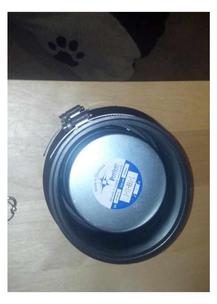

I'm going to be building a Pluto-esque speaker with these NHT buyout drivers. The thing that worries me is the huge magnetic sheild. Sitting in the rubber plumbing adapter, there is very little room between the sheild and the rubber:
Its about 5/8" of space. Is this enough room to "breath"?
Thanks for any help!

ouch, that is tight
but in this regard the magnet cover is most likely to your advantage
smoothening the 'passage', so to speak
but if the woofer is also playing midrange there might be very audible 'ressonances'
remember that the cone is very thin, and acousticly transparent
not sure it will move enough to actually be a 'breathing issue'
but thats what its called

Thanks for your input guys. Tinitus, I'm not sure I understand your smoothening comment, but I think I get the resonances comment. You're saying the space around the sheild might act as a port, like in a subwoofer box, and affect the frequency response around that resonant frequency, right?
I've calculated the space around the sheild to equal 6.21 cubic inches. But to find the resonant frequency of that space, will I also need to calculate the volume of the entire enclosure? I haven't calculated the volume yet.
Math makes my head hurt, so I think I'm going to try Andersonix's suggestion and see if i can remove the shield
