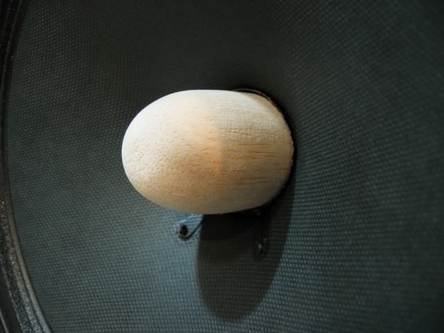

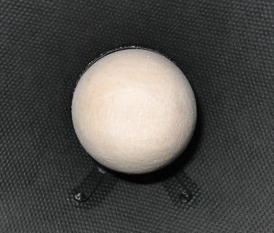

To rough in the shape and since the one dowel size of 5/8 or whatever it was fits nearly perfectly it makes more sense to me to rough in the shape with the eggs. Then a Dreml tool or something with the phase plug chucked into a drill could be used for shaping.
After sawing one of those eggs with a hack saw and the egg in a Vice Grip and then cutting the dowel to size in a hand miter box and trying to keep everything square it'll be a number of days if ever that I try to fine tune it any more.
The length is actually more like 1.5 inches over all. A little wood putty
provides a surface to do some smoothing and getting the centering of the tip right. I haven't done a good listening test yet.
Last point: I've gotten at least reasonably good at removing the dust cap so that 50% has been going smoothly.

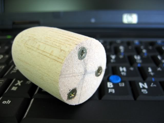

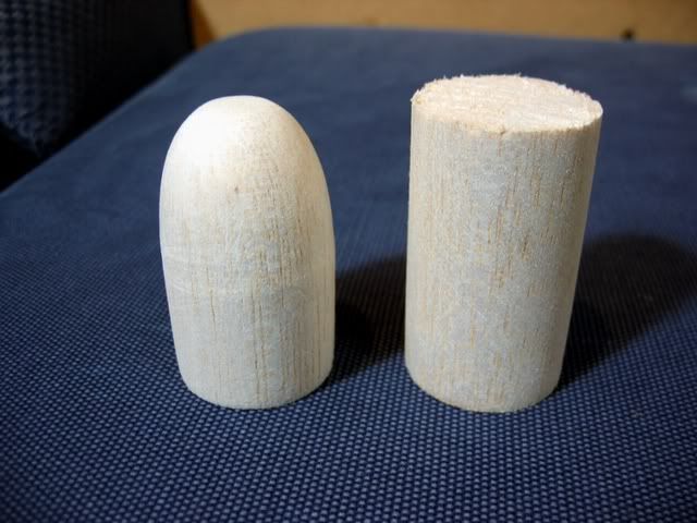

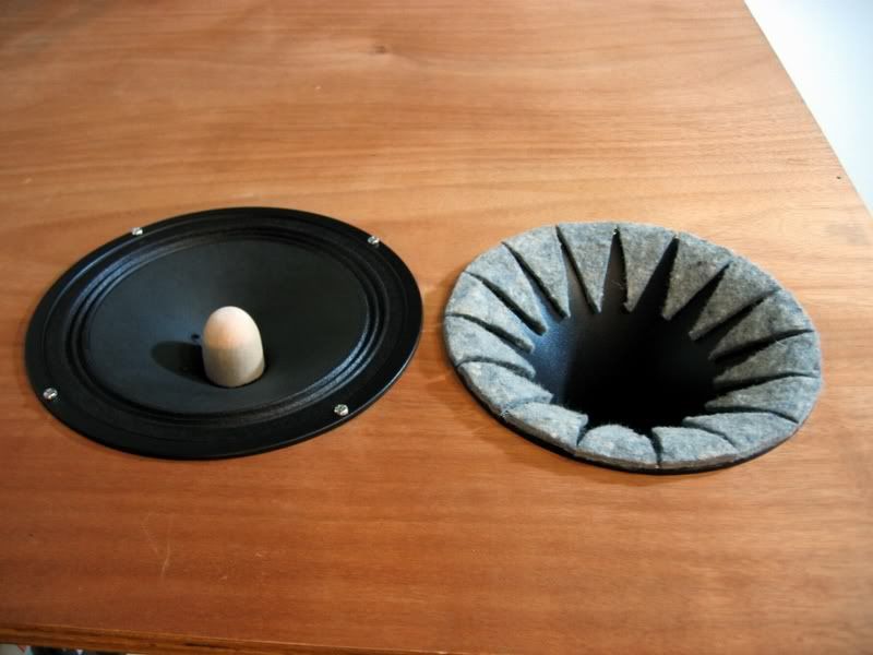

This was an 8" fullranger I bought from local audio shop. It came with paper cone and paper whizzer, quite a smooth and sweet sounding unit. Used with open baffle for a while in a small room, and stored away. I dug it out and made it the "midrange" of my newly developed 3way OB.
Being a midrange, its whizzer is not needed anymore, so it's cut, together with the paper dust cap. OTOH, I happened to acquire a piece of balsa wood which was lathed as a rod.
Looking at both, the balsa rod seemed fit in the pole piece of the driver! How convenient! But the balsa rod was actually slightly largher than the voice coil former, thus can't be fitted in.
Fortunately the balsa is so soft and easy to work with. By just knife and sand paper, I managed to rubbed off a layer, shrank the diameter a little, and shape it into a bullet:
Fitted onto the pole piece of driver by 3 wood screws and magnet attraction:
It's quite a tight fit. The gap between former and plug is less than 1mm.
The sound seemed smoother but not changed very much -- I don't use it all the way to the top, though. Maybe this makes it not so significant. Looks pretty anyway😀
This is the midrange with the tweeter WG:

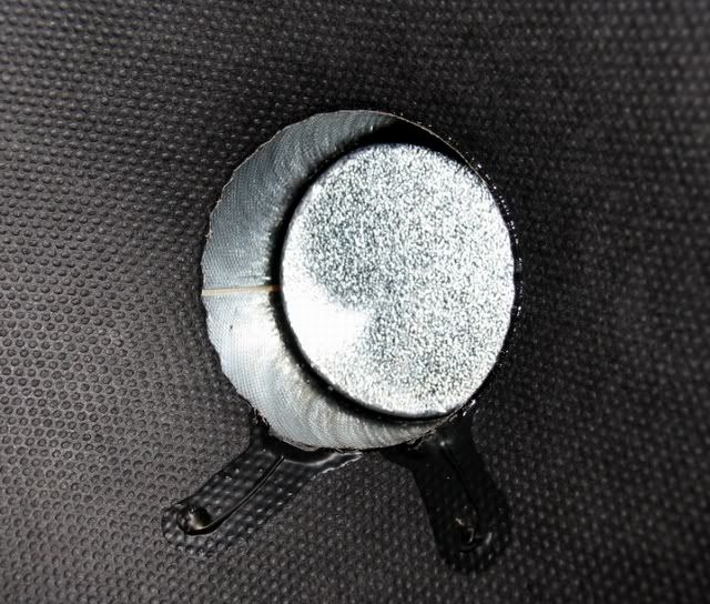

Inside the voice coil former and in front of the center pole piece, there is a cylindrical space. So it's 'straight-sided'. The contour of phase plug also has a section of this straight side. So, even the gap is very small, they don't rub. On the last picture above, you may see the gap at the upper left side is slightly larger (still small, though), and in other portion of the circle, they seems touched. No, they don't touch. It's because of the shooting angle and len's distortion.
Like planet10, I also use screws on the back of phase plug and make them flush (as possible). By the attraction of the pole piece, it can be fixed properly and also movable -- pretty handy in adjusting the position.
In fact my phase plug isn't perfectly round, the gap is not constant along the circle. I'm OK with this imperfection.
Some more pictures:
