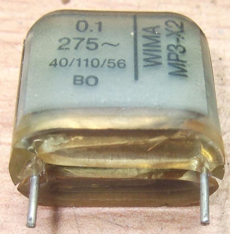

Yes it is not as old as 30 years perhaps 20 years.
We were discussing line filter failures when I dug it out for a photo shoot.
We found that some line filters were failing after about 10 years old with capacitors of various makes using the same resin encapsulation as this one.
And that is an X2 rated part according to the markings. Resin encapsulated cap failure happened to me to,
http://www.diyaudio.com/forums/power-supplies/246394-dc-blockers-mains-filters-2.html#post3722631
This one has split open while laying NOS in a drawer for a few years.
BO manufacture series, aka over 2 decades old. Wrong drawer.
