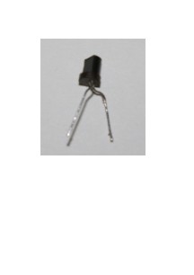

I have on amplifier Mc-Intosh with transistor broken: 026.
I have just referenced 026
Add Pic of this Tr.
http://www.hiboox.com/image.php?img=a2576da9.jpg
Do any of you know this transistor?
Thanks so much.
Pierre

Hello Santosa
Mc Intosh transistors are all referenced 132-xxx . If you can read on the component itself the 3 numbers , it means that your transistor is a 132-026.
In the Mc Intosh transistors data book the 132-026 is a 2N3417 with Vceo selected . Mc Intosh transistor perefect substitute is a 132-095 (GEX32W6047) marked 095 .
I hope this will help you .
Sorry for the delay to answer but I did not see you post before today....
