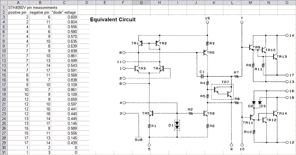

I did some testing and I'm not sure the chip is blown. No pins were shorted at all and the "diode test" results seem to be consistent with the equivalent circuit in the datasheet. I did find a blown 1/2 watt metal film resistor which I think is 19.1k ohms that connected to pin 4 and then to the collector of an MPSA92.
Someone at Definitive has said they can give me some information about the amp, which I'm hoping includes a schematic, so that should help.
I've attached a picture with the pin voltage readings I measured with a copy of the equivalent circuit pasted in as well, if anyone is interested at looking at it. To clarify, the two lines at the bottom with '0' meant no reading, all pin combinations not shown had same reading. All readings taken from chip out of circuit.

pin 4
Looks to me like pin4 is usd to bias the front end of the amp. If the transistor that 'supplies' this pin is blown, I'd expect the amp to be silent...
Without more info it's difficult to diagnose with any accuracy, but fixing the transistor and it's associated components may take care of the problem...

Re: pin 4
The resistor was the only defective component I found. Still not sure if the chip itself is bad, but it seems it may be okay. I'm hopeful that replacing the resistor would fix the amp, but I still have more components to test and I'm waiting on a schematic before I attempt to fix and test.

Here's a WAG: if muting is implemented by a 19.1k resistor used from pin4 to ground (or worse +ve), with the mpsa92 stealing current to -ve, the 1/2w resistor is close to it's rating with ~85v rails (to +ve would exceed it's power rating). If it is also an overload or protection mechanism, the resistor could be subject to high temps if the mute/protect is on too long...did the previous owner like to play it loud?

bigger resistor
Bearing in mind I am guessing about whats going on here:
The use of a bigger resistor would be an excellent idea, I'd use something more like 2W or 5W if the connection point is to +ve instead of ground.
The app note for the chip shows a 10k resistor to ground, perhaps Definitive doubled the value to make the +ve connection safer...anyway you can always use a pair of 9 or 10k resistors to get more power handling at the value you need, I'm pretty certain this value isn't critical.

Well, you were right about the resistor. After spending a few hours going over the board with a multimeter and not finding anything strange followed by lots of thinking, I took a few resistors, strung them together to get around 18-20K, put them in and put it all back together and plugged it in. It worked!

The Definitive guy got back to me. He sent a schematic. The resistor that blew was R89, which is on page 5.

A note in the schematics mentions a reduction in the idle current at mute...not sure if it matters, since it looks like the resistor in question is most stressed under normal operation...
A couple of things are clear from these diagrams...
Assuming your model has the same voltage rails listed on the schematic, the 19.1k resistor sees 24+66v under normal operating conditions, which gives 0.42w dissipation, a little close to the 0.5w rating for my taste. Inserting a 5w resistor would probably be overkill...1 or 2w should have a long and useful life...
The schematic 'claims' a rating of 250w into 4 ohms, presumably with 66v rails, but then claimes the limiter is set to give a peak of 360w into 4ohms (180w RMS). There is a little comment that suggests there are other versions with different power ratings, perhaps there is some mixing of settings here...
