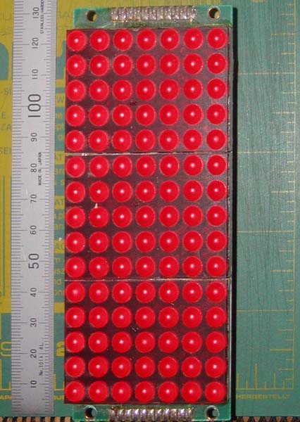

i want to make a USB input device using some of these.I have many of them from some LED signs that were thrown out because the cpu boards were toast.
i cant figure out what is actually happening, they say the LED also acts as a light dependant diode, but once the LED is off to measure, where does the light come from to measure?

The on-off time of LEDs is quite fast. If you run them at a lower duty cycle, you can use the "off" time to photodetect. I haven't read the Mims paper, but ambient light might work. Even better (I think) would be to scan, i.e., turn the LEDs off one at a time and use the remaining light of the others as illumination.
The diodes can operate as emitters and detectors simultaneously. There will be small fluctuations in the voltage across the LED if supplied with a constant current, depending on the amount of light hitting the LED. The light may be from another source, or just light from the LED reflected back to the LED.
