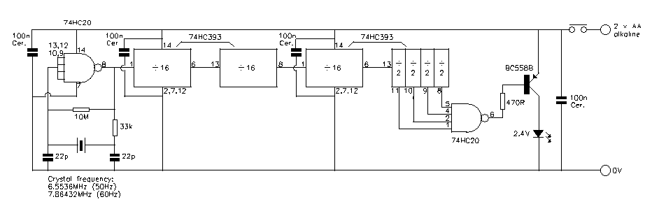

Talk to Martin Bastin and have a 60Hz pulley made; the motor in a 301 or 401 runs better from 60Hz. Build a 60Hz supply if you like, but use a 50Hz strobe light on your 50Hz platter. If you're really keen, replace the neon with rectangular LEDs driven from your 50Hz strobe light.
okay, driving the motor with 60Hz makes sense to me.
But to build a second power supply for a 50Hz strobe sounds like a pain.
Would a 5534 provide enough grunt to drive the LED? Would I need a higher power amplifier to drive a setup xformer for the neon lamp.
Sorry, but one more question on Imbabi's design - what rating in necessary on the 12-0-12 xformer for the oscillator? I'm thinking real small. I found a 6 watt in RS. (Maybe that's enought to drive two 5534's - one 50Hz, another 60Hz?)
Not at all. The requirements are quite different. Use a really high brightness red or orange LED (blue, green, or white will require 4.5V from three AA cells).
