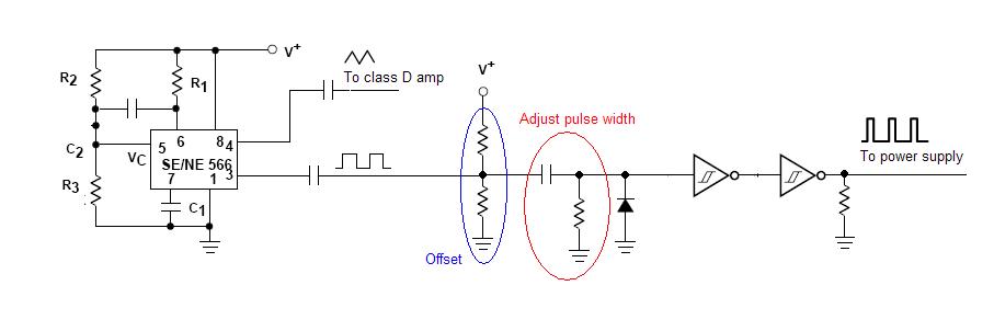

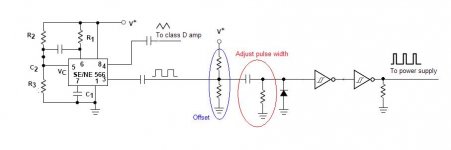

Hi Daq,
You have to synchronize the SMPS and class D amp to a master clock.
