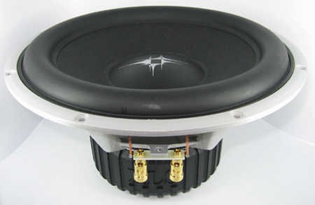

I've just purchased an 830845 Peerless XXLS Sub-Driver for a sealed application.
I’m thinking on using a Qtc value of 0, 62 meaning that I will be obliged to go for an aprox. 100 liter box, since the main purpose of this subwoofer is to play in an audiophile stereo system and/or a 5.1 application to play mainly music concerts!
I would like to have any kind of input from this community that would help me to make the right decisions to achieve the best possible sub application with this driver.
I was also thinking on using a Rythmik Audio - A370-Special Edition (SE) and a Linkwitz Riley Transform for my application.
Since this is a non-servo setup (I would prefer if it would be a Servo application but I don't know how I could implement such a setup), I'm a little concerned with de max excursion of the drive and with the clipping of the amp. Any suggestions?

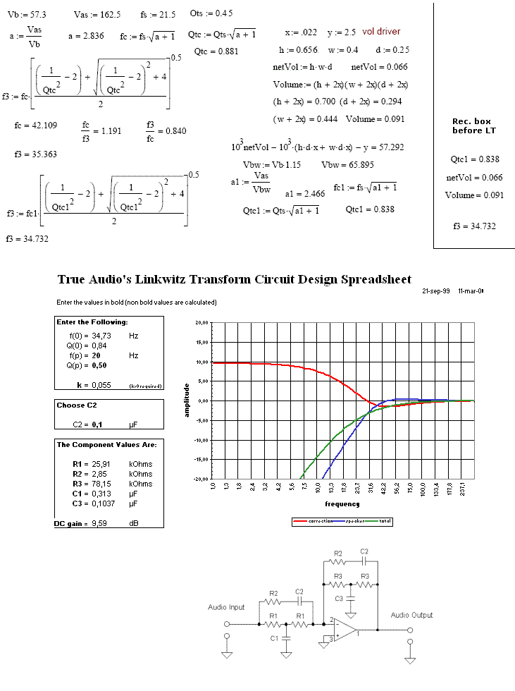

Hi there...
I would Like to know if anyone can help e with the LT circuit for this specific sub (Peerless 12" xxls - 830845) with th Ruthmik Audio A370 Plate amp?
I'm considering on purchasing rithmyk's plate amp and chaging it's RC values to achieve a better set for my sub.
I've made some plots and I've come up with a 110,6 L sealed box!
Is'nt it a box too big?

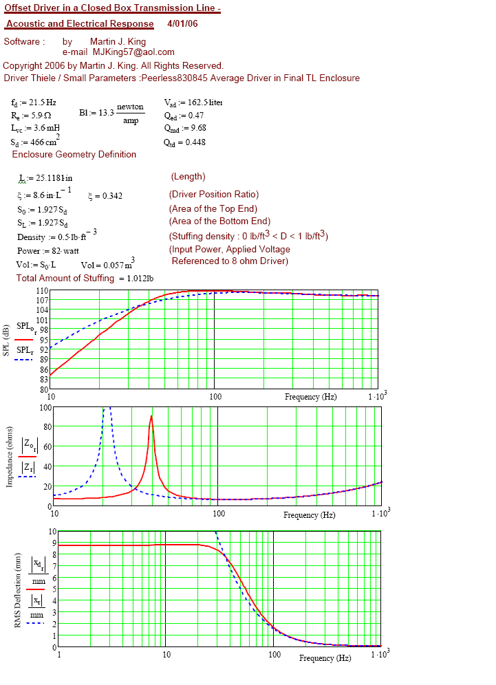

I´d suggest a completely different style of cabinet--- a dipolar one.
The high Qts-Versions of the Peerless are quite well suited for this application and it has the advantage of lowering the Fs even more and featurung extremely small cabinet dimension.
Besides that, the sonical reproduction quality is very high. Dipoles don´t boom, but deliver some of the most precise, natural and ´fast´ Bass You can get.
One drawback is that You need a lot of diaphragm area and longthrow capability to gain serious SPLs. Just one driver will be enough for music that´s played well above normal conditions, but with 2 drivers You´ll have more than sufficient reserve even for Homecinema.
Example:
2x 830845
Cabinet: 36*36*36cm (14.2"*14.22*14.2" or ~48Liters)
Fs: ~15-16Hz.
SPLmax,1m: @20Hz @15Vrms: ~100dB
@30Hz @25Vrms: ~109dB
@40Hz @40Vrms: ~114dB
You further need a passive correction network, consisting of 2 coils and one Cap that linearizes the sub to ~ +-1dB between 26Hz and 160Hz (nearfield).
A active Subsonic-filter is recommended. A basslift shouldn´t be necessary in most rooms, but could be added for ´Fun-mode` ;)
jauu
Calvin

Tiff_Needle said:
Hi there...
110 litres is too big if you are going to use a Linkwitz transform. That box size is good for this driver in a sealed box - will give the best response.
Strictly speaking, the driver is not the best choice for a LT, as the Fs is low. Part of the advantage of using an LT is to make the driver work below it's impedance peak. To make the impedance peak hapen at a higher frequency, you reduce the box size.
As far as the amp goes - it's ok, should give 300 watts at the~6 ohmsof this woofer. Depending on the amount of boost the LT provides, and the source material (music, HT) clipping shouldn't be a problem.
Disabled Account
Joined 2007
For this driver, 50 litres would be a good size. Boost would be around 14dB, with a box Qtc of .85 and Fb of 44 Hz. This pushes your impedance peak up to 45 Hz. Not great, but about as good as this driver will get with a relatively low power amp and moderate boost.

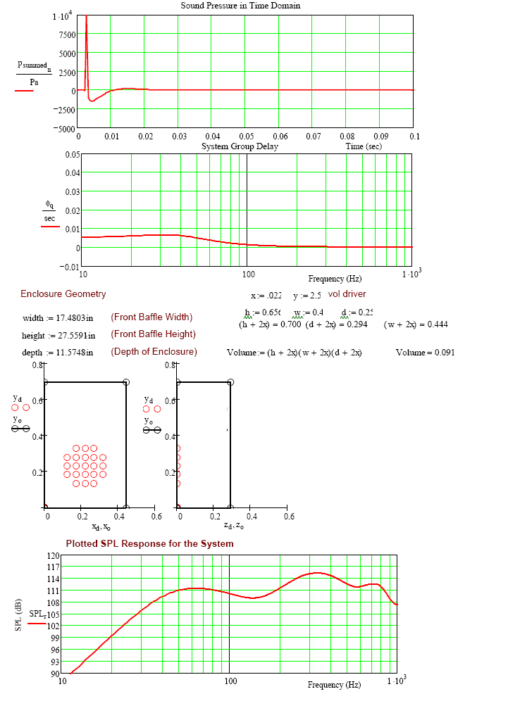

the dimensions are a result of the simulation I use. Since this is the same as used for a commercial product, please understand, that I don´t disclose the script. I could provide You with figures though. The experience gained over the years showed, that this script gives very precise and practical results, as long as the parameters of the driver are correct.
SL´s Site is a marvellously valuable piece of work and a must read for everyone interested in dipole technology.
Still though I prefer a similar but (always) smaller style of cabinet, that looks more pleasing to my eyes and that has distinct acoustical differences.
First it is a symmetrical cabinet, which Subs after SLs design are more than often not (if 2 or n*2 drivers are used) and second does it lower the Fs of the drivers condsiderably and raises Qt a bit. We´re talking of 5 to 10Hz reduction (sometimes more), depending on the driver and the cabinet´s size.
This has the advantage that You can use drivers with an slightly elevated Fs because of a stiffer suspension or/and lower diaphragm weight. This way You can use a lot of excellent PA-Drivers in the 15"-18"-class with remarkable results. They benefit from their good weight/force-relationship, their huge diaphragm size and their good highpower behaviour. What they usually lack (for homehifi) are a few Hz in Freq-response. But that is provided for by the very small cabinet (keep in mind that the shipping cartonage of the drivers is usually a bit larger than the actual cabinet size of this small dipole-type!! And the sim-figures I provided are for a pair of XXLS, hence ~24L for one XXLS vs. 50-110L in CB and still a lower Fs!).
The result can be an outstanding precise and deep bass with ´speed´ like no other. Sonically I´ve the impression of the combination of the goods of a Horn-bass with the ease and deep-going bass of an TL. There is of course a penalty to pay and that is a reduced efficiency and maximum SPL and a bit more of effort with the compartement building. But to me its worth trying ;-)
I find it much more comforting to have the driver do what it naturally wants to do, than to brute force him to an ´unnatural´ behaviour. While a L-transformed CB works fine on paper, in practise there will be audible sonic penalties, too much for my taste, but it might be ok for anybody else.
jauu
Calvin

Hi.
This driver in the configuration outlined in my previous post will not come near max excursion. Xmax for it is 13mm +/-, so about 1 inch in total. If anything, I'd reduce the box size even further, to drive up Fs, and increase LT boost and amp power. OR, skip LT altogether, and allign for a passive radiator in a small box.
As I've said before, this driver is not the ideal choice for an LT, better a higher efficiency, higher Fs pro type driver with a large Xmax.

Hi Rob,
When I said smaller box, it was strictly in reference to the Fs of the driver which is very low to begin with (22 Hz). The best advantage to LT is to make the driver work below Fs, thereby giving the amp a steady impedance to drive, rather than a large peak. A better driver for LT would be one with a higher Fs, such as 40 Hz, and of course, a bigger cone would also be good.;)
Like I mentioned before, this driver would work well in a small box with a passive radiator (or two), and with enough power should be able to hit ~ 120 dB at 20 Hz. This would probably be the best use for the driver IMO.
The frequency I used in the Linkwitz transform spreadsheet to calculate gain was 20Hz.
