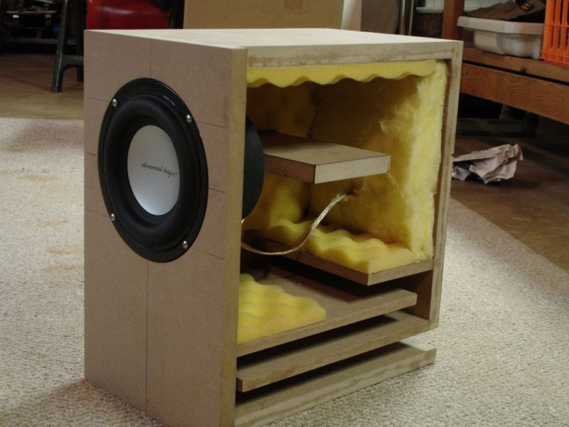

beerman 16th February 2007 03:45 PM
you could try this, though it's a lot of cutting and not very efficient because of the snaking port.

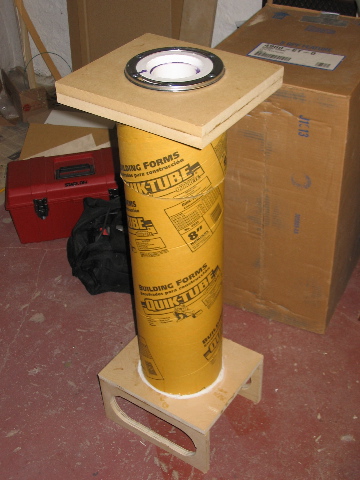

pjanda1 16th February 2007 10:53 PM
2 Attachment(s)
I built this odd contraption for the MCM 55-2421, a cheaper clone of the W8-740C. I choose this as I had the left over parts. The enclosure is a tube with a 7.25" i.d.. If memory serves, the thing is about 30" long. It has a pvc port with a 3" i.d., about 27" long. The driver fires into the bottom. The port is held in with a closet fitting, that is filed by hand to be very flared. Obviously, it's not the ideal solution in terms of resonances, but it works pretty well. It models -3db a little below 40hz, and it pretty flat to 35hz in room. The port chuffs easily with 30-35hz sine waves. I gave it to my step brother. With the typical stuff he listens to, it sounds great. There isn't enough content down there for the chuffing to be audible. It also isn't the most efficient use of space, but it fits decently at the very front of his trunk. It's a cheap and easy build. It's an easy way to get a long enough port into a small enough enclosure.
This is my least favorite implemenation of three I've tried for this driver. However, the 8ft transmission line isn't going to work in your car. (I no longer needed it, so I cut it down to build the ported enclosure.) I also built a passive radiator system for a friend. Its tiny and works great. Its an E.B.S. that reaches 30hz easily, but must be crossed over below 60hz. Unfortunately, the nice, cheap P.R. I used isn't available anymore. I haven't seen another cheap P.R. that has enough mass to tune suitably and enough Xmax to use the drivers capabilities. I think it would be silly to pay twice as much for the P.R. as for the driver.
I know the TB Neo is a bit differnet, but I thought I might give you some ideas. The Fitzmaurice AutoTuba would be great if you have the room and can build it. Note however, that he uses a little sealed box in his own trunk, as he, like most of us, doesn't need that much bass in his car.
Whatever you choose, I predict you'll be very happy with that driver in your car.
pj
