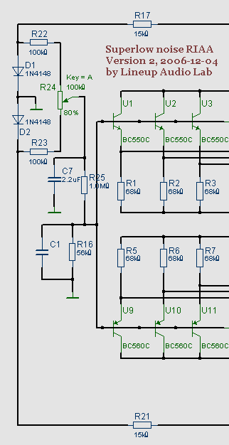

Zero Cool.
In my attachment you see how I did this in one of My amplifiers.
It is the components in upper left.
The potentiometer adjusts, how much current, positive or negative
that is provided by R25, 1 MOhm.
By using such high resistor, we do not effect Input Impedance, too much.
Another way, using current sources for active bias compensation
is to be found in this lineup topic.
Including diagrams.
Offset Correction using Bias Compensation
In your amplifier I would try the more simple method
or something like it.
Like is shown in my Attachment.
