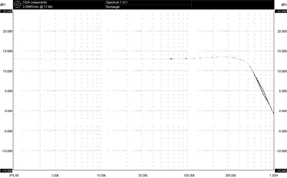

I am posting a general question and am hoping for some constructive ideas.
In the few Class-A power amps that I have built, typically an Aleph-X, the closed loop frequency response always seems to have a hump before the -6dB decay, indicating inductivity somewhere.
Of course one can damp this down by increasing the value of the capacitor across the feedback resistor.
But I wonder where the inductivity comes from and how it may be removed.
The frequency response as shown is with a speaker as load, but it does not change much even if the speaker is removed and replace with say a 100 ohm power resistor.
It also changes little even if one increases the values of the gate resistor of the output FETs.
Any comments as to what the root cause of the hump might be ?
Thanks,
Patrick

The hump means that you have a higher Q value to the rolloff
than you probably want, meaning there are at least 2 poles
of rolloff operating before you reach the unity gain point at high
frequencies.
There is nothing technically wrong with this, but as a rule we
like to remove it for sonic or at least aesthetic reasons. You
can do this by lowering the frequency of one of these poles
(that is to say, slow down some portion of the circuit) or by
raising the frequency of one of the poles (speeding up some
part of the circuit).
Usually we just trim the feedback cap, and that works fine.
I should add the a 500 KHz rolloff is quite fast, so you have
some bandwidth to burn IMHO.

EUVL said:[snip] But the hump indicates excessive gain at high frequencies. In fact, if you take out the feedback cap entirely, the hump would be more prominent.[snip]Patrick
Another way to say this is that you have still a lot of gain when the phaseshift increases. Such a case means that the negative feedback tends to change to positive feedback which means increase of gain rather than decrease. As Nelson pointed out, you can decrease the phase shift, or increase the gain roll-of with frequency to get rid of it. Problem is often that these things are coupled, for instance if you increase the gain roll-off with a cap you probably at the same time increase phase shift so it doesn't get you very far.
Or you can increase the closed loop gain (less feedback).
Jan Didden

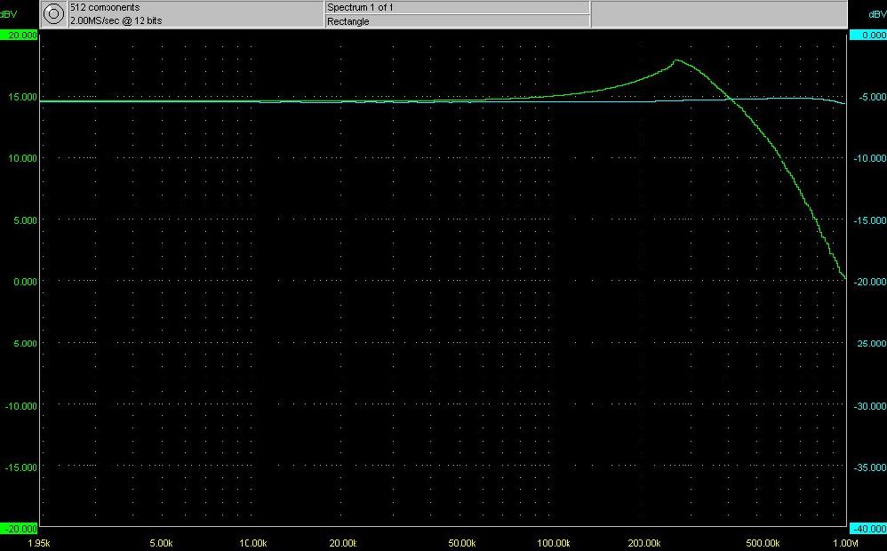

Jan,
I already don't have much feedback, only 30dB or so.
And this hump only appears at one side of the X amp output relative to ground when driven by a single ended (not balanced) input. The other side has flat response to roll off -3dB at 1.5MHz, as I have expected. So I do not understand it fully yet.
I am going to drive the thing with balanced inputs in the next days and see what happens. It may be that I have too much common mode current going from the outputs to ground. But I only thought of this last night, and haven't had time to verify yet.
Patrick
Patrick

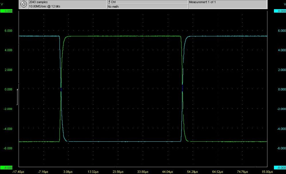

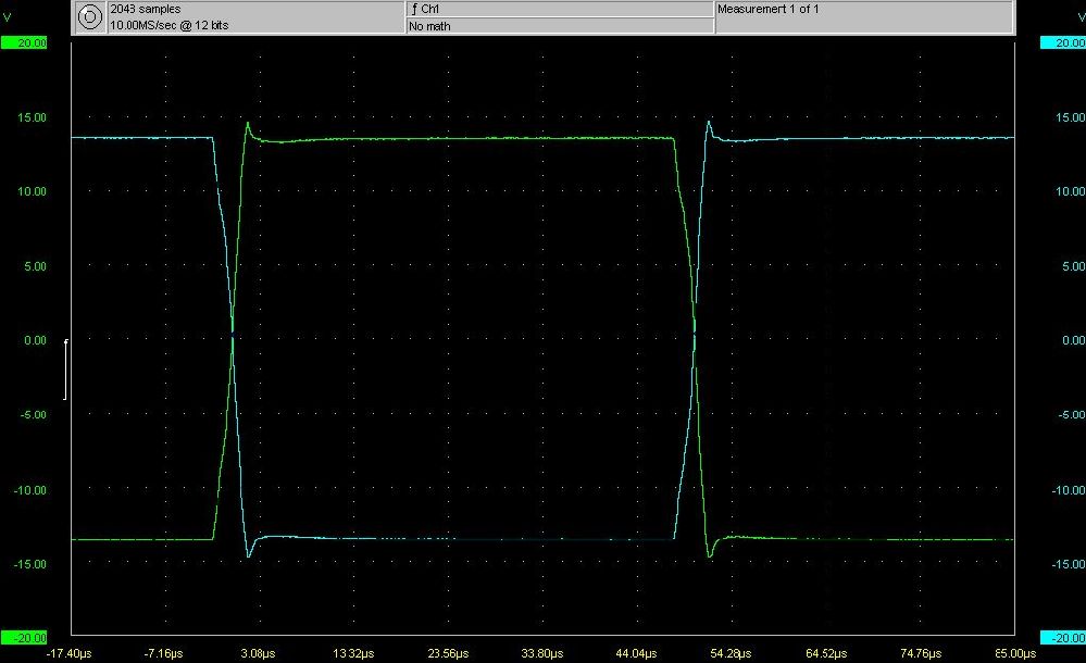

I am using 2SJ109BL for the diff pair, ZVP4424A cascoded at -7V, current source is 2SJ74BL @ 8mA, cascoded by J174 @ -5V. Source resistors are 10 ohm, drain resistors 910 ohm. Magic resistors 10k.
I have tried doubling the gate resistors (from 432R to 1k) but it does not improve things. Currently the feedback cap needs to be 10p // 50k to get rid of the hump. Small signal square wave is then fine. Large signal (+/- 12V Vout) square wave has a small spike, which I found surprising. Load was the Stereophile dummy speaker (4ohm reactive load). This is now with balanced input from a DRV134. I have measured the freq response of the chip, flat to 1MHz, though square waves have tiny spikes. The frequency response in post #1 was measured using sweep sines.

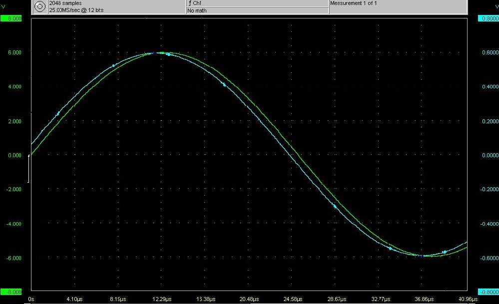

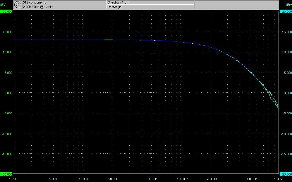

I hope I have sorted all measurement bugs out including differential probe bandwidths, etc., so here are the results driven by balanced signals.
Frequency response with 2p feedback cap, balanced sine input 0.5V, dummy speaker load.
Green is +Vout to Gnd, Cyan is +Vin to Gnd.
Negative side is now identical.
EUVL said:20kHz sine wave showing input / output phase shifts
Patrick,
I think you are seeing problems that aren't really problems. +3dB @ 200kHz, so what?
Do you have an input low-pass filter on that amp? You should have one to keep out anything that isn't audio. Like -3dB @ 50kHz? I bet your hump thing will be gone then anyway.
Jan Didden
