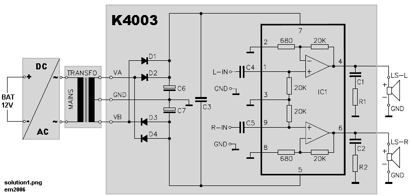

Your amplifier is designed for mains fed applications, the circuit is optimally designed for symmetrical power supplies.
Velleman K4003 stereo amplifier needs a supply voltage 2X12VAC/2A(50W).
This amp cannot supply from car's battery directly, you need a CONVERTER (or, you can use two batteries - see manual Page 8 - but it is a inconvenient solution).
The best solution is to buy an amplifier that need 12VDC power suplly.
The K4003 needs a symetric power supply (double power supply).
If you'll try to use a single supply, you will destroy the amplifier.
The Velleman K4003 is constructed to use a transformer connected to mains voltage:
-version 1 - OPEN-FRAME TRANSFORMER 48VA 2 x 12V / 2 x 2A
Order Code: 212048
http://www.velleman.be/es/en/product/view/product.asp?id=997#
-version 2 - TOROIDAL TRANSFORMER 50VA 2 x 12V / 2 x 2.08A
Order Code: 5012
http://www.velleman.be/es/en/product/view/product.asp?id=1909#
If you want to use a car battery anyway, two solutions are posible:
1- a transformer above mentioned and a DC/AC converter wich converts the
12VDC to 230VAC (see attached solution1.png)
2-a DC/DC converter wich converts the 12VDC to 2x15VDC (see attached solution2.png)
The 2nd solution is preferable.
Using the converters in this application is an inconvenient solution.
Is more simple, reliable and cheaper to buy an amplifier that need 12VDC power suplly.
