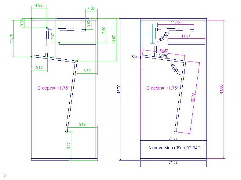

Gentlemen,
I posted a message a while back for a "simple to build" enclosure for the Fostex FE 206 ES-R.
From this post, I received a lot of good advice from Scottmoose for building a BIB -TQWT. He even did the calculations for me (thanks again BTW). So everything was ready to R&R.
So I was all ready to go, except that I discounted the WAF in my plans : my future ex-wife threw a serious tantrum when she look at my plans and discovered that these beautiful boxes would be over 2 meter tall...
Not planning to move out of the house in the near future and be forced to sleep in my car, what recommendations would you have for an enclosure taking care of the Wife Acceptance Factor.
1) Fostex recommended enclosure for the FE 206 ES-R ? as per the attached file.
2) A Nagaoka D58-ES ?
3) Others ??

That design is slightly different from the one posted on Madisound's website for the ESR:
http://www.madisound.com/pdf/fostexdrivers/fe206esr-rev.pdf

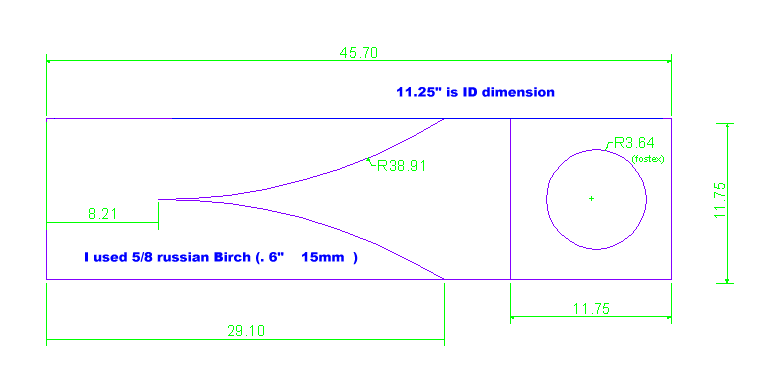

My buddy Frank recently completed a pair of these (quite a daunting task ), they sound fabulous, but make sure you have a furniture dolly handy to move. Even in baltic birch plywood instead of MDF, these are well over 100lbs each, and awkward to boot.
The finished dimensions are 370mmW x 1071mmH x 532mmD
Chris has pointed you to the correct Factory box for the ES-R. Much, much better than the cabinet for the standard FE206E. Basically, as you'll see, the ES-R box is a refinement of the Nagaoka D-58.
As an alternative easy to build cabinet, the Factory design for the FE208ESigma is a well designed box, and should do OK with the ES-R units.
