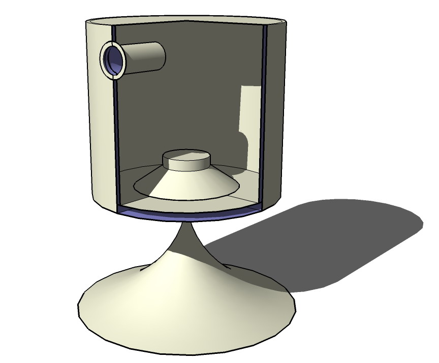

What exactly would you like to model?
For room acoustics I can suggest CARA (cheap)
For FEM/ BEM loudspeaker box (enclosures of any type) I would suggest PAFEC Vibroacoustics (Very Expensive)
Or teh software AkAbak which is now free but requires some knowledges.... It is like the LspCAD but without the Microcap Like UI, but with SCRIPTS!
Hope this helps,
Tamas

Oh, that's very nice to have a feedback!
Well, what I am looking for is a kind of omnidirectional loudspeaker for my garden. The idea is to orient the speaker down, and to use a kind of a acoustic mirror under the box. But I don't know if such a thing iwould be able to sound. Do I need several HF speakers at the top or they can also work on sound reflection for the cone?
So, what software I can use to simluate the function of this stuff, more precisely to calculate a right volume for the box AND the right shape for the acoustic mirror at the bottom?
